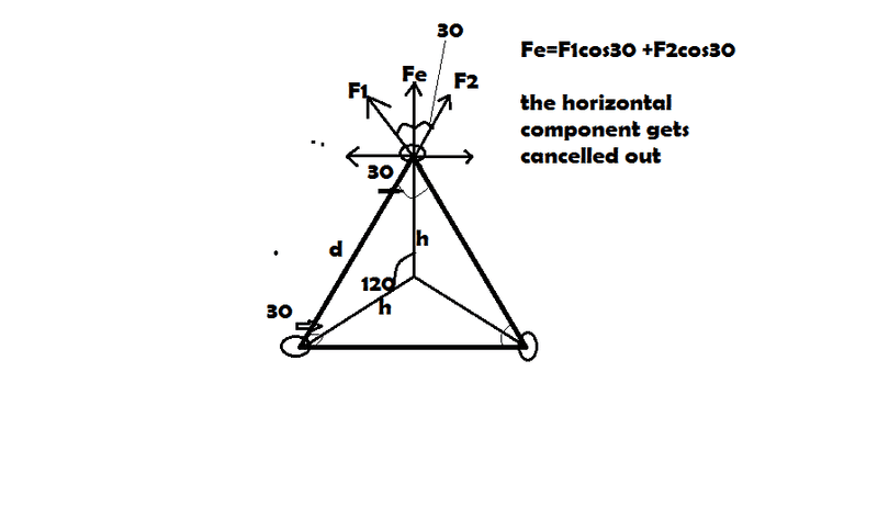

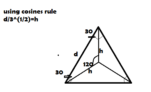

not understand how you get d=(3)^(1/2)
w=d(3)^(1/2)
w is not d*(3^1/2)
its d/(3^1/2)
in the picture youre looking at the pyramid from the top..

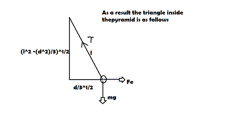

got the solution...thanks
Again looking at the pyramid from the top we see that the horizontal component of the force due to the two charges gets canceled out...
in the end use the followin equation
tsin a/tcos a= Fe/mg
