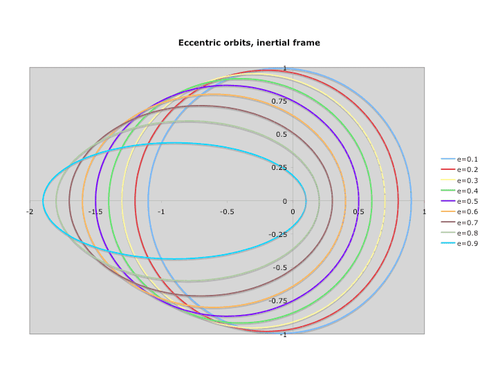

Kepler's laws talk about elliptical orbits.
Here are nine elliptical orbits as viewed from the perspective of an inertial frame. All nine orbits have the same semi-major axis and orientation, but the eccentricity varies from 0.1 to 0.9 in steps of 0.1.
With this inertial perspective, the shapes of the orbits are simple and well-known (ellipses that share a common focus, and in this case, share a common semi-major axis). The descriptions of the orbits are once again simple and well-known (Kepler's laws). The equations of motion are yet again simple and well-known (Newton's second law + Newton's law of gravitation).
There is no centrifugal force in this picture.

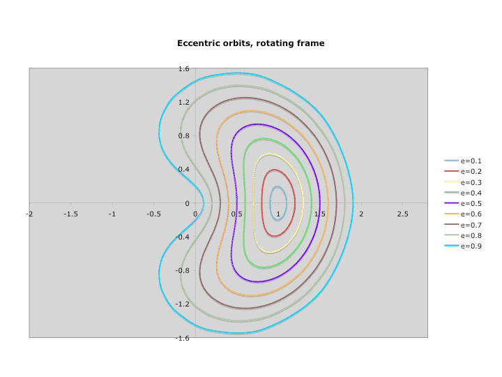

To get a centrifugal force you must be observing things from the perspective of a rotating frame. The only case for which centrifugal force exactly counterbalances gravitational force is a circular orbit (inertial point of view) viewed from the perspective of a frame rotating at the planet's orbital rate. The planet does not move from this perspective. There is no orbit from this perspective.
What if the orbit (inertial perspective) is elliptical rather than circular? The planet will move, but the behavior is, bizarre. Here are the same orbits depicted above, but this time viewed from the perspective of a frame rotating with the mean motion of these orbits:
With this rotating perspective, the shapes are complex (this family of curves may have a name, but I don't know what it is). The descriptions of the orbits are complex, as are the equations of motion (Newton's second law + Newton's law of gravitation + centrifugal force + coriolis force).
