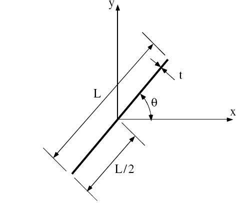

Hi guys,
I would like to derive the Ixy equation from simple integration and I can't seem to get the right answer (third equation down the picture). I seem to be able to derive Ixx and Iyy easily but product moment of area requires first moment of area to be calculated and I just don't know how to do that on an inclined section.
Any help would be apprecited on this issue.
Thank you.

Is the rod in the x-y plane? And what is t?
ok, you need to prove that Ixy = L3t(sin2θ)/24.
Show us the integral you have for this. :smile:
This one I've figured out! :-p
x = cos(theta) . s
y = sin(theta) . s
dA = ds . thickness
limits for s = L/2 and -L/2
