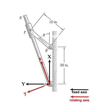

Planar Kinematics of a Rigid Body (Relative Motion Analysis using Rotating Axes)
In summary, the speaker thanks those who respond to their question and explains that they have attempted to solve the problem using various methods, but are unsure if their solution is incorrect. They mention calculating the angular velocity and differentiating it to check the angular acceleration, but found that the values do not match. They also state that they need to derive equations before using computational software.
parabolic
Let me start by saying thank you to any responses I receive. I understand the methods for solving this problem but I have concluded that either part or all of my solution is incorrect.
After solving for the angular velocity, I differentiated my answer in order to check the angular acceleration. I then calculated the values of my solution and the derived solution from the velocity for some sample values of theta... They don't match. So either both my ang velocity AND my ang acceleration are incorrect.. Or only my acceleration is incorrect.
The problem statement says to use computational software, but I must first derive the equations..
*EDIT* I have converted all inches into feet
Thanks again
Due to limitations in posting methods, I have attached a pdf with my relevant equations and an attempt at a solution.

Anyone? Bueller?
Thank you for sharing your work and equations. It is always important to check and verify your solutions, especially when using computational software. There are a few possible reasons why your solutions may not match:
