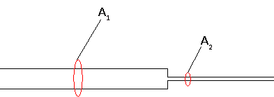

In a pipe of varying diameter in which an ideal fluid is flowing, there's an increment in the kinetic energy of each particle as it reaches a region of lower cross section from a higher cross section in the pipe.
Following the law of conservation of energy, there should be an energy transfer in some way which allows this increment in kinetic energy; the energy stored by virtue of pressure in the fluid is said to provide this energy but in an ideal fluid, there can't be any energy stored though pressure...so considering an ideal fluid in this situation, where does this energy come from?
E.g in this case of an ideal fluid flow -
This additional K.E by virtue of y cannot come though conversion of pressure to K.E since an ideal fluid cannot store energy using pressure.
I've tried by best to explain the situation, but if you still do not understand, please complaint.

Is it possible that the mass density of your ideal fluid in the little section of pipe is different than the mass density in the big section? This is assuming that the kinetic energy remains constant in both sections.

Flow energy. The pressure is acting on the area of a fluid element (a force) which causes it to move some distance (d) which results in work. Since the total energy is constant, and, in this case equal to,
[tex]\frac{P}{\gamma} + \frac{v^2}{2g}[/tex]
the KE must increase since the flow energy has decreased in order to satisfy the Conservation of Energy.

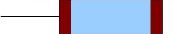

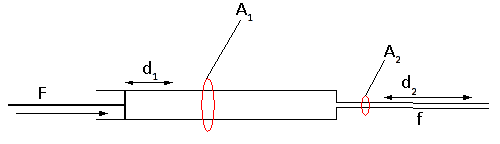

There should be some work done to make the fluid flow. Suppose in such a pipe -
A force F acts though the piston and into a distance d1 doing work F d1; considering the ideal nature of the fluid inside the pipe, the input work done should be equal to the output work done and so on the other end, a force of f will be acted by the fluid though a distance d2 such that -
F d1 = f d2
With the knowledge of F d1 and d2, one can estimate that f will be larger than F -
Assuming F = 10
d1 = 15
d2 = 5
150 = 5f
f = 30
A higher force application will mean more acceleration and so more kinetic energy in the fluid which's in the smaller cross section area of the pipe...All this results in the the fluid fluid gaining more kinetic energy by virtue of the work done on the fluid.
Notice, to allow the fluid to keep flowing, there should be continuous application of force (to do the work)...if the flow is solely to rely on...for example inertia of the fluid (which contains limited kinetic energy) the fluid flow might stop before all the fluid drains out of the arrangement, reason being the motion will be used to do work on the fluid towards the narrower section of the pipe.

A force F acts though the piston and into a distance d1 doing work F d1; considering the ideal nature of the fluid inside the pipe, the input work done should be equal to the output work done and so on the other end, a force of f will be acted by the fluid though a distance d2 such that...
What force f? There aren't any objects there for the fluid to imparting a force on. And as such...
F d1 = f d2
Assuming F = 10
d1 = 15
d2 = 5
150 = 5f
f = 30
That's all just nonsense.

dE_logics said:
F d1 = f d2 ... With the knowledge of F d1 and d2, one can estimate that f will be larger than F
Since d2 is greater than d1, then f will be smaller then F. Also there's no net work being done on the fluid, (the center of mass of the fluid is not accelerating) so the actual equation should be:
F d1 + f d2 = 0.
static pressure ... dynamic pressure ... energy
pressure is energy per unit volume.

Oh no...I forgot that the d2 is a length...not the diameter...thanks for correcting...I'll fix it.
I've fixed the derivations and hopefully it does not have any more issues.

Both F and f are the forces applied to the imaginary pistons in the pipe in your example. The pressure near each piston is defined as:
pressure = (force on piston) / (area of the piston surface)
The pistons are the source of the pressure on the fluid.

dE_logics said:
So...if suppose I have a 5 ton object place on the piston of a piston cylinder apparatus holding an ideal fluid and the piston does not move on placement of that object, the energy possessed by it will be pressure x volume?...completely independent of the displacement of the piston?
No. There is no displacement involved so no work is being done.
Jeff Reid said:
Since it's an imaginary incompressable fluid, there is no displacement, just an increase in pressure. Energy is the ability to perform work, but in the case of an incompessable fluid with no movement, there is no means to harness that energy.
There is a displacement, hence why the energy is pressure x volume. The volume results from the displacement of the fluid element as it flows through the pipe (i.e. area x length of the displacement = volume).
Thanks...that clears things up.

I've been thinking about how best to explain this issue and I think I now have it. The key is in understanding what a "simplifying assumption" is and how the concept is applied. A simplifying assumption is used to make calculations easier and is something that is assumed to be true but really isn't. Now how can such a thing be acceptable? How can you assume something to be true if it isn't? The answer is that as long as the error caused by the simplifying assumption is small enough not to significantly affect your conclusions, it is acceptable to use it.
So now to the incompressible flow assumption itself. We all know that air is compressible and any change, no matter how small will compress it. But when you are dealing with low speed flow, the pressure changes and the resulting density changes are very small when compared to atmospheric pressure and the density of air at atmospheric pressure. So the density changes are ignored: The density is assumed to be constant, ie., the fluid is incompressible. And that's all the incompressible flow assumption is about: it does not mean we are assuming there is no internal energy due to the pressure and density of the air.
Now how do we know that the density change is small enough to ignore? Well it depends on your needs. If you need your calculations to be 99% accurate, the maximum speed at which the assumption is valid is higher than if you need the calculation to be 99.9% accurate. A good rule of thumb I learned was the incompressible flow assumption is typically valid below 220 mph. I actually don't know what the error is at 220 mph, but now it's your turn to do some work here:
Step 1: Calculate the change in static pressure required for airflow out of a tank at 220 mph.
Step 2: Use the ideal gas law to determine the fractional change in the density of air with that static pressure change. That fraction is your percent error caused by the assumption.
