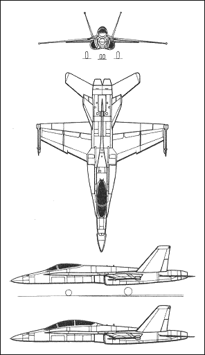

two "vertical" stabilizers on the F-22 Raptor angled
Why are the two "vertical" stabilizers on the F-22 Raptor angled sort of like a V-Tail as opposed to being completely vertical?
To my understanding it is a stealth issue. Right angles are a no-no. I would imagine there are also benefits from getting some more horizontal effect instead of pure yaw control as well.
Thanks! Using it as an elevator was the only thing I could think of as well. Why are right angles a no-no when it comes to stealth?
If you imagine a right angle corner.
Whatever angle an incoming radar beams hits one surface at it will bounce of that then the other and return along the same direction - directly back to the radar set.
With an obtuse angle it will be reflected away in another direction.
It's the same principle as a corner cube - where you want the light to go back the same way.
Cool. That makes sense, thanks!
I do not buy this "stealth" argument. Many aircraft, F-18, etc use angled twin tails and is not for stealth. It probably has more to do with stability. Note: these aircraft were designed well before stealth design methodlogies were discovered.
Perhaps not fully a stealth issue, but you've got to admit that replacing those two splayed control surfaces with one bigger one mounted vertically, would result in a larger radar signature.
How would it improve stability?
I emailed a good friend who is head of our wind tunnel. I will quote his response in our email:
There are 2 considerations that have a strong influence on the vertical tail arrangements. Both come into play for rather high angles of attack and occur because of strong vortices which originate near the wing root-fuselage intersection or at a wing leading edge sweep change for some designs. These vortices cause high amplitude buffeting if the tails are too close to them at the most critical angles of attack. The F-14 and F-15 aircraft were strongly affected and had a lot of extra maintenance because of this. The other factor is for certain angles of attack and sideslip one of these vortices impinging on a vertical tail can lead to forces which are in the wrong direction so there needs to be one which is on the upwind side and is completely clear of such wake interactions to guarantee the needed control authority over all angles of attack and sideslip.
So, it's pretty much not for stealth. Note: the F-14, F-15 have straight tails. This was a good observation and interesting question RandomGuy88!

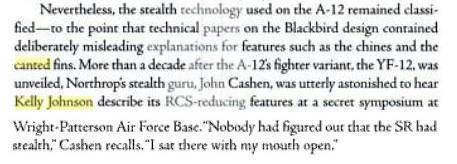

I don't doubt your source for a second (because it is repeated in the link below). However the stealth issue is part of the equation. The SR-71 had them loooooooong time ago and have Blue was in the mid 70's and Lockheed was working on it prior to that. So stealth has been around as long as say the F-14, just not in the open.
http://www.aerospaceweb.org/question/planes/q0157.shtml
http://books.google.com/books?id=fVQRmQo-bfUC&pg=PA17&lpg=PA17&dq=kelly+johnson,+canted+vertical+tails&source=bl&ots=eUPlC_78Qq&sig=WOYbMSciQuyGYzaqH686TVnHObU&hl=en&ei=5C4gS4qtO5XSMo78ucUC&sa=X&oi=book_result&ct=result&resnum=3&ved=0CAsQ6AEwAg#v=onepage&q=kelly%20johnson%2C%20canted%20vertical%20tails&f=false
Note page 8 here:
http://www.scribd.com/doc/18029452/NASA-SR71-Blackbird-Challenges-and-Lessons-Learned-2009
The Raptor's vertical surfaces are significantly more oblique than other craft. Yes, this is to reduce radar signature. The fact that more conventional craft have moderately oblique tails does not change that.
http://www.globalsecurity.org/military/systems/aircraft/f-22-stealth.htm
"A quick look at the F-22 reveals an adherence to fundamental shaping principles of a stealthy design. The leading and trailing edges of the wing and tail have identical sweep angles (a design technique called planform alignment). The fuselage and canopy have sloping sides. The canopy seam, bay doors, and other surface interfaces are sawtoothed. The vertical tails are canted. The engine face is deeply hidden by a serpentine inlet duct and weapons are carried internally. "

Nope. The SR-71 used it and that was the late 50's and 60's with the YF-12. I would call that one pretty successful.
The SR-71 was by no means stealthy to Radar. Read the book "Skunk Works" which disproves your claim. While its certainly true that they tried to incorporate some early methods, they were not successful as per the theory that lead to the design of the F-117or F-22.
The link above that I gave directly states that they were canted in for reduction in RCS. Whether the aircraft was stealthy or not is a moot point (which I disagree with). They were canted because they were thinking about making the aircraft smaller on radar.
