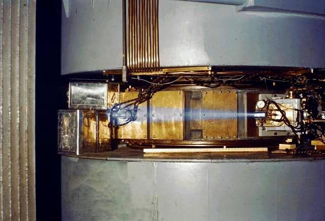

The original cyclotrons had whopping big electromagnets with pole faces large enough to accommodate the vacuum chamber that the particles actually traveled in. A Google search for "cyclotron pictures" led me quickly to this page:
http://www.physics.rutgers.edu/cyclotron/cyc_hist_album.shtml
Notice in particular this picture: Lab staff standing on 184-inch cyclotron magnet

Berkeley (University of California) used to have a cyclotron with pole tips about 184 inches (4.67 meters) in diameter. This was built just after World War II, and used until about 1980, when it was disassembled. It needed about 2 megawatts of power to run the coils. There is a slight vertical focusing that keeps the beam from hitting the vacuum chamber and the "dees" ("D" shaped electrodes) and falling down (gravity). Proton revolution frequencies range from perhaps 10 MHz to over 30 MHz, depending on the magnetic field strength.
