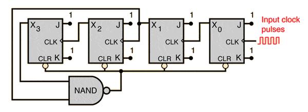

I wanted to ask about a way to cascade or let's say connect two sets of 4-bit flipflop JK counters together..
I want to create a circuit that is an up-down counter from 0 to 99..but as it is known, its difficult to use 8 inputs ofcourse.. so the best way is to have two sets of 4 jk flipflops..the first set will be connected to a 7seg and will count up and down, while the other one will not count up or down unless the first one has finished 10 counts..I hope u get what I mean..
the problem is that I didnt know how to connect the first circuit with the other one, in order for the first one to trigger the second one..do u guys have any idea how can I apply this? thanks a looot in advance :)
The output of the 4th JK counter (X3 in the diagram below) falls when it clocks over from 9 to 0.
You can use this falling pulse to clock the next set of flip flops. You could invert it if the counter needed a rising edge.
You would wire the 1st 4 JKs as a BCD counter so that it divided by 10 but gave outputs from each stage as powers of 2.
So the 1st stage would give a 0 or a 1 and this would be worth 0 or 1.
But if the next stage gives a 1 it is worth 2. The next stage's 1 is worth 4 and the last one is worth 8.
So, 1 0 0 1 is worth 9.
Note the values from 10 to 15 cannot occur as this is a BCD counter.
This would only count up as shown.
However, to do what you want, you could just get a 74LS192 chip or the 4510 which can count up or down, and already give BCD out.
If counting down wasn't important, you could get a 4518 which already has two BCD counters in the one chip, or the 40110 which already has 7 segment drivers in the counter chip. These only count up though.
