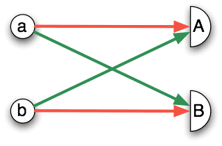

The quantum interpretation of this bunching effect was given by Fano in the sixties. It can be explained by looking at this picture from wikipedia:
Imagine photons are emitted randomly from the points a and b at a constant rate. A and B are detectors. Now one might be interested in the case of detecting photons simultaneously at A and B. Using standard QM formalism (<A| is the probability amplitude connected to detecting a photon at detector A,<B| is the probability amplitude connected to detecting a photon at detector B, |a> is the probability amplitude connected to the emission of a photon at point a and |b> is the probability amplitude connected to the emission of a photon at point b) the expected joint detection rate for random emission will be:
[tex]R_1=|<A|a><B|b>|^2 + |<B|a><A|b>|^2[/tex]
Assuming the simplifying case that [tex]|<A|a><B|b>|^2 =|<B|a><A|b>|^2 =N^2[/tex] this gives a total joint detection rate of [tex]2 N^2[/tex]
However, for indistinguishable particles one must keep in mind that these two possibilities leading to a joint detection are also in principle indistinguishable and can interfere. Therefore the joint detection rate will read:
[tex]R_2=|<A|a><B|b> + <B|a><A|b>|^2[/tex]
[tex]=|<A|a><B|b>|^2 +| <B|a><A|b>|^2 +<A|a><B|b> <B|a><A|b>+<B|a><A|b><A|a><B|b>[/tex]
[tex]=2 N^2 +<A|a><B|b> <B|a><A|b>+<B|a><A|b><A|a><B|b>[/tex]
To evaluate these additional interference terms one has to keep in mind that photons are bosons. This means the wavefunction is symmetric concerning exchange of particles. Therefore
[tex]<A|a><B|b> =<B|a><A|b>[/tex]!
So you get
[tex]R_2=2 N^2 + 2 |<A|a><B|b>|^2=4 N^2[/tex]
The joint detection probability for bosons is therefore twice as high as expected for independent particles. This can also be seen if you shoot exactly 2 indistinguishable photons at a 50/50 beamsplitter. They will always both take the same exit port. However, this does not mean that all photons converge towards one state. In the beam splitter example still 50% of the photons exit through one port and 50% of the photons exit through the other, but the pairs arriving simultaneously will always take the same one. This is the basis of the Hong-Ou-Mandel test, which specifies how indistinguishable two photons are.
Note that the same calculations apply also to fermions. If you do the same experiment with electrons, the math basically stays the same. You now just have to consider that a fermionic wavefunction is antisymmetric in terms of particle exchange. So in this case:
[tex]<A|a><B|b> =-<B|a><A|b>[/tex]
and accordingly you would get
[tex]R_2=2 N^2 - 2 |<A|a><B|b>|^2=0[/tex]
for the joint detection rate of fermions, so fermions will never occupy the same state. Sounds familiar?

If I am understanding this correctly, the additional possibilities would only be indistinguishable in a stream. Could one emit 1 photon simultaneously from each source a and b, thus removing the interference? The interference would be impossible, since it would require 4 particles detected when only 2 were emitted. In this case would photons always pool, and never spread?
It is unfortunately not that easy. Although since the times of Dirac it is pretty common to talk about interference of particles, Glauber already noted in his Nobel speech that this concept can lead to severe misconceptions. The easiest description is therefore given in terms of interference of probability amplitudes instead of interference of particles.
This means that you - very much in the sense of Feynman - just take all events, which start with the emission of 2 photons at a and b and end with the detection of two photons at A and B and have their wave functions interfere. The small difference is shifting the interference from the particle to the wave function, but this makes the basic conception somewhat less misunderstandable. Therefore you do not need 4 particles, but you need 4 completely indistinguishable events (<A|a>,<B|a>,<A|b>,<B|b>).
So getting back to your question:
If you emit 1 photon simultaneously from a and b and are in principle able to keep track, which is which, those 4 events are distinguishable and the interference vanishes.
If you just have two detections at A and B, but are in principle unable to know, which photon is which, the interference is there. The situation is somewhat similar to the double slit, where the interference also vanishes as soon as you make the two paths via the two slits distinguishable somehow.

I understand the 4 events are indistinguishable (<A|a>,<B|a>,<A|b>,<B|b>). The roadblock for me, is that the event <A|a><B|a><A|b><B|b> is indistinguishable from the event <A|a><B|b>+<A|b><B|a> since the first event would seem to have each detector go off twice, whereas the second has each detector going off once.
Now we need to have to use clearer notation, I fear. These terms are in principle wavefunctions associated with events, not the probability amplitudes of these events. Therefore you need indeed 4 of these terms. Let me consider
[tex]\psi_1=<A|a><B|b>[/tex] and [tex]\psi_2=<A|b><B|a>[/tex]
It is important to remember, that the physically important thing is the probability density instead of the wave function.
So in the case, which you call [tex]<A|a><B|b>+<A|b><B|a>[/tex], this would be just [tex]\psi_1+\psi_2[/tex], which is just a sum of two wave functions, but no probability density. The measurable expression would be:
[tex]|<A|a><B|b>|^2+|<A|b><B|a>|^2 = |\psi_1|^2 + |\psi_2|^2[/tex] and the event
[tex]<A|a><B|a><A|b><B|b>[/tex] is [tex]\psi_1^* \psi_2[/tex].
So you get [tex]|\psi_1|^2 + |\psi_2|^2[/tex] in the distinguishable case and
[tex]|\psi_1 + \psi_2|^2 = |\psi_1|^2 + |\psi_2|^2 + Re(\psi_1^* \psi_2) +Re(\psi_2^* \psi_1)[/tex] in the indistinguishable case. The latter is a typical interference term in QM. Does this make it more understandable or even worse?
