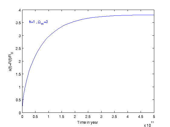

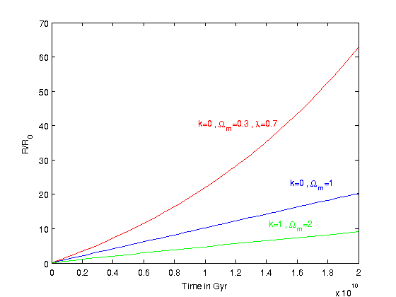

thanks for your answers, i begin to see more clearly. I posted here because I'm making in Matlab the simulation of the scale factor evolution in time, in the 3 cases that friedmann equations allow. (k=-1,0,1).
I managed to get the good curves ( see figure 1 in attachment) for :
[tex]\Lambda=\lambda*3H_{0}^{2}=0[/tex] and k=0 [tex]\Rightarrow \rho_{0}=\rho_{crit}[/tex] (see blue line)
[tex]\lambda=0.7[/tex] and [tex]\Omega_{m}=0.3[/tex] and k=0 [tex]\Rightarrow \rho_{0}=0.3* \rho_{crit}[/tex] (see red line)​
We can see on red line an accelerated expansion which is the expected result in this case.
Now, i'd like to get the recollapse case where [tex]\Omega_{m} > 1[/tex] and k=1 with [tex]\Lambda=0[/tex].
This case is represented on green line. I chose [tex]\Omega_{m}=2[/tex].You may notice there's not a recollapse of the universe with my code, the scale factor always increases, that's not normal. I use the MATLAB solver "ode45" to resolve the following differential system (it's based on Runge-Kutta algorithm):
eq number 1 :
[tex] \frac{R^{''}}{R}=-\frac{4\,\pi\,G}{3c^{2}}(\rho \, c^{2}+3\,p)+\frac{\Lambda}{3} [/tex]
eq number 2 :
[tex] \bigg(\frac{R^{'}}{R}\bigg)^{2}=\frac{8 \pi G \rho}{3}+\frac{\Lambda}{3}-\frac{k c^{2}}{R^{2}} [/tex]
You can see i added [tex]c^{2}[/tex] factor to [tex]\Omega_{k}[/tex]. I decided to put the "meter" dimension to [tex]R(t)[/tex] according to your advice. So , [tex]\Omega_{k}=-\frac{k c^{2}}{H_{0}^{2} R_{0}^{2}}[/tex] is dimensionless like [tex]\Omega_{m}[/tex].
we can rewrite the equation number 1 in the form :
eq number 3 :
[tex] R^{''}=\bigg(\frac{-4 \pi G}{3c^{2}}(\rho c^{2}+3 p)+\frac{\Lambda}{3}\bigg) R^{'} \bigg(\frac{8 \pi G \rho}{3}+\frac{\Lambda}{3}-\frac{k c^{2}}{R^{2}}\bigg)^{-1/2} [/tex]
with matter density :
eq number 4 :
[tex] \rho=\rho_{0} \bigg(\frac{R_{0}}{R(t)}\bigg)^{3}[/tex]
In my source code, I decided to work with the following variable :
[tex]a(t)=\frac{R(t)}{R_{0}}[/tex]​
wich gives :
eq number 5 :
[tex] a{''}=\bigg(\frac{-4 \pi G}{3c^{2}}(\frac{\rho_{0} c^{2}}{a^{3}}+3 p)+\frac{\Lambda}{3}\bigg) a^{'} \bigg(\frac{8 \pi G}{3} \frac{\rho_{0}}{a^{3}}+\frac{\Lambda}{3}-\frac{k c^{2}}{R_{0}^{2} a^{2}}\bigg)^{-1/2} [/tex]
Finally, we have the following differential system :
y1'=a'=y2
y2'=a"
Here's the MATLAB code part for k=1 and [tex]\rho_{m}=2 \rho_{crit}[/tex] :
Code:
function friedmann
H0=71000/(3*10^(22));
cv=3*10^(8);
t_begin=380000*(3600*24*365); % time where uiverse become transparent
t_final=20*10^(9)*(3600*24*365); % 20 Gyr
init=[ 0.001 ; 10^(3/2)*H0 ]; % redshift z=1000=a_0 ; a'_0=10^(3/2)*H0[t3,y3]=ode45(@syseq3,[t_begin t_final],init);
figure(1);
t3=t3/(3600*24*365);
plot(t3,y3(:,1),'g');
end
function dydt3 = syseq3(t,y)
p=0;
k=1;
cv=3*10^(8);
G=6.673*10^(-11);
rho_crit=3*H0^(2)/(8*pi*G);
rho_0=2*rho_crit;                 % Omega_m=2
Lambda_red=0;
Lambda=Lambda_red*3*H0^(2); % Cosmological constant=0
R0=cv/H0;       % got by the relationship between Omega_k and Omega_m (Omega_m=2 here)
 dydt3=zeros(2,1);
 dydt3=[ y(2) ;
       (-(4*pi*G)/(3*cv^(2))*((rho_0/y(1)^(3))*cv^(2)+3*p)+Lambda/3)*(y(2))*((8*pi*G*rho_0/y(1)^(3))+Lambda/3-k*(cv/(R0*y(1)))^(2))^(-1/2);
end

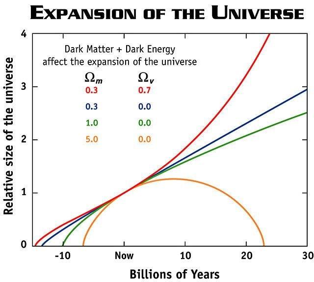

I'd like to get the orange line on "size_universe.jpg" (in attachment) with the famous "recollapse".
Do you know what's wrong in my modelisation ?
Sorry for this long post but i wanted to be as explicit as possible.
Regards.

I haven't looked into your code in detail, but I suspect that the problem is a problem of units. The determination that k = 1, 0, or -1 is a particular choice of units, and may be messing you up. Basically, the reason why some theorists choose to set the curvature parameter in these terms is that if the curvature is positive, negative, or zero, you can always change your "reference time" so that k = 1, 0, or -1.
However, with the usual formulation of the Friedmann equations, we explicitly fix the scale factor to be equal to 1 at the current time, so this degree of freedom is taken up, and we have to allow k to take on any floating-point value.

For the case k=1, i determine automatically [tex]R_{0}[/tex] which appears only one time in my differential system :
[tex]R_{0}=\frac{c}{H_{0} (\Omega_{m}-1)^{1/2}}[/tex]​
I have a strange result if i take [tex]\Omega_{m} \geq 3[/tex]. Indeed, the scale factor ( in fact, [tex]a(t)={\frac{R(t)}{R_{0}}[/tex]) increases initially and
stabilizes after. See on figure2.png in attachment. Actually, in the case of the recollapse, the problem may be "stiff". I tried others MATLAB solver for stiff problems like "ode15s", "ode23s", "ode23tb" but always the same behaviour, the scale factor follows an asymptote and doesn't decrease as it's expected. For [tex]1 \leq \Omega_{m} \leq 3[/tex], the scale factor always increases without asymptote. Why does this result occur from 3 ? a relationship with speed of light ?
Thanks.

As I said, don't use the integer values for k. You have to fix other things in order to get sensible equations if you use k = 1, 0, -1 (also, k = 1 does not mean [tex]\Omega_k = -1[/tex]). I suggest you use [tex]\Omega_k[/tex] instead. The value of [tex]\Omega_k[/tex] is exactly specified by the value you choose for [tex]\Omega_m[/tex], using the constraint I wrote previously.

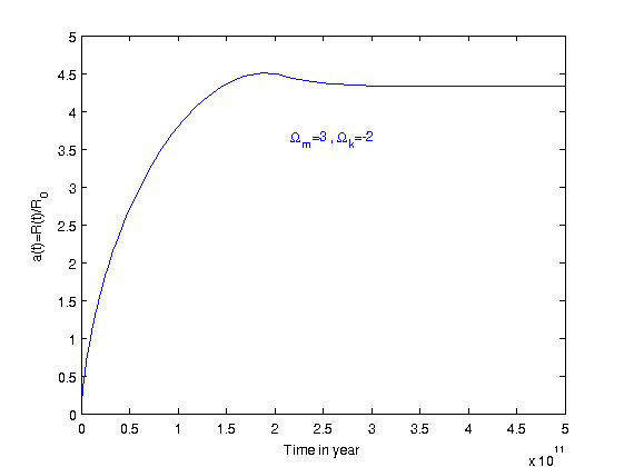

hi,
i took your advice considering now in my differential system [tex]\Omega_{k}=-\frac{k c^2}{H_{0}^2 R_{0}^2}[/tex] with the constraint :
[tex]\Omega_{k}+\Omega_{m}=1[/tex]​
i get so the following differential equation :
[tex] a{''}=\bigg(\frac{-4 \pi G}{3c^{2}}(\frac{\rho_{0} c^{2}}{a^{3}}+3 p)+\frac{\Lambda}{3}\bigg) a^{'} \bigg(\frac{8 \pi G}{3} \frac{\rho_{0}}{a^{3}}+\frac{\Lambda}{3}+\frac{\Omega_{k} H_{0}^{2} }{a^{2}}\bigg)^{-1/2} [/tex]
here's the associate code part:
Code:
dydt3=[ y(2) ;
       (-((4*pi*G)/(3*cv^(2)))*((rho_0/y(1)^(3))*cv^(2)+3*p)+Lambda/3)*(y(2))*((8*pi*G*rho_0/y(1)^(3))+Lambda/3+(Omega_k*(H0/y(1))^(2)))^(-1/2);
I have always got the same result for [tex]1 < \Omega_{m} < 3[/tex], no collapse. For [tex]\Omega_{m} \geq 3[/tex], the problem seems to be stiff, see the result on figure 3 in attachment ( procuced by "ode45" Matlab solver).
someone has already encountered this problem in differential system solving ?
is there a solution to this issue ?
Thanks

What are you using for p?
Anyway, you should be able to do a similar thing as follows. First, using the parametrization I used above:
[tex]H^2(a) = H_0^2 \left( \frac{\Omega_m}{a^3} + \frac{\Omega_k}{a^2} \right)[/tex]
Note that I no longer even need to worry about things like factors of G and pi and whatnot: everything is just in terms of density fraction and expansion rate, dramatically simplifying things.
Then, I can go about solving the differential equation by using the definition of the expansion:
[tex]\left( \frac{1}{a} \frac{da}{dt} \right)^2 = H_0^2 \left( \frac{\Omega_m}{a^3} + \frac{\Omega_k}{a^2} \right)[/tex]
[tex]\left( \frac{da}{dt} \right)^2 = H_0^2 \left( \frac{\Omega_m}{a} + \Omega_k \right)[/tex]
[tex]\frac{da}{dt} = \pm H_0 \sqrt{\frac{\Omega_m}{a} + \Omega_k}[/tex]
Whether or not there is a recollapse depends entirely upon the argument under the square root. If [tex]\Omega_k < 0[/tex], then the argument under the square root will become negative for [tex]a > -\Omega_k/\Omega_m[/tex]. Thus there is necessarily a maximum value for the scale factor a in this case.
A second essential feature of this formula is that it is symmetric: the expansion rate for a given density is the same whether that rate is positive or negative. This means that the recollapse is perfectly symmetric with respect to the prior expansion.
My suspicion is that when you're using this solver, you're running into some sort of radius of convergence issue where the value at [tex]\Omega_m = 1[/tex] is interfering with the code's ability to extrapolate beyond [tex]\Omega_m = 3[/tex]. I bet that if you don't try to go beyond the point where the recollapse begins (because you know it's going to be symmetric with respect to the prior expansion), you won't run into any problems.
Edit:
Actually, the more I think about it, the more I think that you've done something incorrect with the pressure. The pressure p is a function of what sort of matter you have. For normal matter, it's zero (as far as cosmology is concerned).

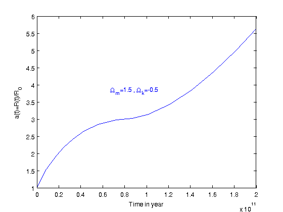

Hello,
I'm on the right track, the simulation gives coherent results. I think the problem of "no recollapse" is the change of sign in :
[tex] \frac{da}{dt} = \pm H_0 \sqrt{\frac{\Omega_m}{a} + \Omega_k}[/tex]
Indeed, [tex]\frac{da}{dt}[/tex] is positive at the beginning and vanishes for :
[tex]a=-\frac{\Omega_{m}}{\Omega_{k}}[/tex]
So, we've got to report this change of sign in the differential equation system. I used the "sign" command of Matlab in this way :
y1=a(t)=R(t)/R0
y2=a'(t)
Code:
dydt3=[ y(2) ;
       (-((4*pi*G)/(3*cv^(2)))*((rho_0/y(1)^(3))*cv^(2)+3*p)+Lambda/3)*y(2)/H0*sign((Omega_m/y(1)^(3))+Lambda_red+(Omega_k/y(1)^(2)))*(abs((Omega_m/y(1)^(3))+Lambda_red+(Omega_k/y(1)^(2))))^(-1/2);
You ca see i put : " sign((Omega_m/y(1)^(3))+Lambda_red+(Omega_k/y(1)^(2)))" in front of the absolute value of "(Omega_m/y(1)^(3))+Lambda_red+(Omega_k/y(1)^(2))))^(-1/2)". Well, i respect the positive value for the square root.
Then, i get for [tex]\Omega_{m}=1.5[/tex], [tex]\Omega_{k}=-0.5[/tex] and [tex]\Omega_{\Lambda}=0[/tex] the figure number 4. I said the results are coherent because there's a break on the curve for a=3, which is expected because a' vanishes for [tex]a=-\frac{\Omega_{m}}{\Omega_{k}}=3[/tex] in this case. Now, i have an infinite expansion for [tex]\Omega_{m} > 1[/tex], no more problem with the previous post concerning factor 3.
From we can see on figure 4, i failed to tell the solver that there's a change of sign. Anyone could see a solution to this ? I thought "sign" MATLAB command would be the solution but after vanishing of a'(t), a(t) increases once again like we notice it on figure 4.
Thanks.

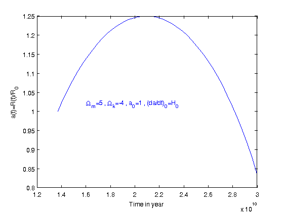

Hello,
i have reformulated the differential system through your equation :
[tex]H^2(a) = \bigg(\frac{1}{a} \frac{da}{dt}\bigg)^{2} = H_0^2 \left( \frac{\Omega_m}{a^3} + \frac{\Omega_k}{a^2} + \Omega_\Lambda \right)[/tex]
which gives equation n°1 :
[tex] \left( \frac{da}{dt} \right)^2 = H_0^2 \left( \frac{\Omega_m}{a} + \Omega_k + \Omega_\Lambda a^{2} \right)[/tex]
then we have :
[tex]a = \Omega_{m} \bigg( \frac{1}{H_{0}^{2}} \bigg(\frac{da}{dt}\bigg)^{2} - \Omega_{k} - \Omega_{\Lambda} a^{2} \bigg)^{-1}[/tex]​
So, the differential equation can be written in this way :
[tex] <br /> a''=\bigg(\frac{-4 \pi G}{3c^{2}}(\frac{\rho_{0} c^{2}}{a^{3}}+3 p)+\frac{\Lambda}{3}\bigg) \Omega_{m} \bigg( \frac{1}{H_{0}^{2}} \bigg(\frac{da}{dt}\bigg)^{2} - \Omega_{k} - \Omega_{\Lambda} a^{2} \bigg)^{-1}[/tex]​
Finally, i managed to get the curve representing the "recollapse" with [tex]\Omega_{m} > 1[/tex], [tex]a_{0} = 1[/tex], and [tex]a'_{0} = H_{0}[/tex] and [tex]\Omega_{\Lambda}=0[/tex] (see figure 5 in attachment) . The integration begins at [tex]t_{0}=13.7 Gyr[/tex]. The results are validated by the value of the maximum of scale factor before the recollapse :
[tex]a_{max} = a ( - \frac{\Omega_{m}}{\Omega_{k}} )[/tex]
[tex]t_{max} = - \frac{5}{-4} = 1.25[/tex] on the figure 5​
I would like to get the first part of this curve ( for [tex]t0 << 13.7 Gyr[/tex] ), ie from different initial conditions. I tried with these conditions :
[tex]a_{0} = 0.001[/tex], and [tex]a'_{0} =H_{0} (5*10^{3}-4)^{1/2} = 70.6824 H_{0}[/tex]
respecting so equation n°1 for the value of [tex]a'_{0}[/tex]. For this case, the Matlab solver begins integration at [tex]t_{0}=380.000 years[/tex], so a redshift z=1000.
I get the figure 6. There's well the recollapse design but the maximum is not equal to 1.25 (much more little, about 0.09 ) and the big crunch occurs fastier than on figure 5.
What's the problem, How it is done ? Why i don't get the same recollapse as in figure 5, i mean the same maximum and time "t_final" of big crunch ( [tex]a(t_{final})=0[/tex].
Thanks a lot.

I don't think you've made proper use of the acceleration equation. What are you using for p?
Edit: Also, have you made certain that [tex]H_0 = H(a=1)[/tex] always?

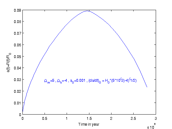

Hello,
the problem persists. Everything is OK for [tex]a_{0} = 1[/tex] and [tex]\big(\frac{da}{dt}\big)_{0} = H_{0}[/tex] (see https://www.physicsforums.com/attachment.php?attachmentid=22861&d=1262647111"
" Maybe I see the problem.
LaTeX Code: asingle-quote_{0} = H_{0} (5*10^{3}-4)^{1/2} = 70.6824 H_{0}
Looks like you're missing a factor of a in this equation, as H = a'/a. "
If i take [tex]a = 0.001[/tex], [tex]\big(\frac{da}{dt}\big)_{0}[/tex] is given by the following formula :
[tex] <br /> \left( \frac{da}{dt} \right) = H_{0} \left( \frac{\Omega_m}{a} + \Omega_k + \Omega_\Lambda a^{2} \right)^{1/2}<br /> [/tex]​
So, in my example, i have :
[tex]\Omega_{m} = 5[/tex], [tex]\Omega_{\Lambda} = 0[/tex] and [tex]\Omega_{k} = -4[/tex]​
which gives:
[tex]\big(\frac{da}{dt}\big)_{0} = H_{0} (5*10^{3}-4)^{1/2} = 70.6824\,\,H_{0}[/tex]​
and with this, the result of the plot is wrong , see https://www.physicsforums.com/attachment.php?attachmentid=22862&d=1262647111"
Indeed, the maximum of scale factor is equal to about 0.9 instead of [tex]a_{max} = - \frac{\Omega_{m}}{\Omega_{k}} = \frac{5}{4} = 1.25[/tex] here.
I put my Matlab code :
Code:
function friedmann
cv=3*10^(8);
t_final=40*10^(9)*(3600*24*365);
Omega_m=5;
Omega_red=0;
Omega_k=1-Omega_m-Omega_red;
a_0=0.001;          % value of a_0
a_prim_0=H0*(Omega_m/a_0+Omega_k)^(1/2);    %value of a'_0
init=[ a_0 ; a_prim_0 ];
[t3,y3]=ode45(@syseq3,[t_begin t_final],init,options);
t3=t3/(3600*24*365);   %time in year
plot(t3,y3(:,1),'b');
end
cv=3*10^(8);
G=6.673*10^(-11);
cv=3*10^(8);
G=6.673*10^(-11);
Omega=0;
rho_0=5*rho_crit;
Omega_m=rho_0/rho_crit;
Omega_red=Omega/3*H0^2;
 dydt3=zeros(2,1);
 dydt3=[ y(2) ;
 (-(H0^(2)/2)*(Omega_m/y(1)^(3)-2*Omega_red))*Omega_m*(1/(H0^(2))*y(2)^2-Omega_k-Omega_red*y(1)^(2))^(-1);
end
As you can seen, with a redshift equal to 1000 ( because a_0 = 0.001), i begin the integration at t_begin ~ 380000 year.
I don't understand why the maximum is not the same than with [tex]a_{0} = 1[/tex] and [tex]a'_{0} = H0[/tex]. If i take a value between "1 and 0.001" , "0.1" for example, the maximum "1.25" is nearly reached (see figure 7 in attachment, the max is equal to 1.24 ) .
I really don't know why this max is modified by other initial conditions than [tex]a_{0} = 1[/tex] and [tex]a'_{0} = H0[/tex]. The equations seems to be correct, the code too. It comes maybe from the time at which i begin integration. This time is a function of the initial value of [tex]a_{0}[/tex]. For example, i have for [tex]a_{0} = 0.001[/tex] a time corresponding to about 380000 years, when the universe became transparent.
however, The main goal is reached even if i have difficulties with earlier ages.
Thanks.
Oh, that's wrong. The correct formula is:
[tex]\left( \frac{1}{a}\frac{da}{dt} \right) = H_{0} \left( \frac{\Omega_m}{a} + \Omega_k + \Omega_\Lambda a^{2} \right)^{1/2}[/tex]
i don't think, you wrote the following equation previously :
[tex] \left( \frac{1}{a} \frac{da}{dt} \right)^2 = H_0^2 \left( \frac{\Omega_m}{a^3} + \frac{\Omega_k}{a^2} \right)[/tex]
Oh, hmm, perhaps I am mistaken. I forgot that you'd already multiplied the a through. Okay.
I do think, however, that the problem is something very simple like this. You're still using the energy density rho in your equations, though. You don't have to. You might be able to fix the problem by changing completely to the much simpler formulation that only makes use of density fractions, and not using the constants G and c at all.

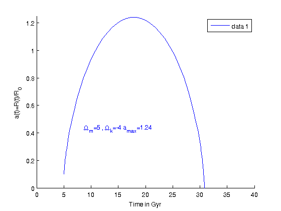

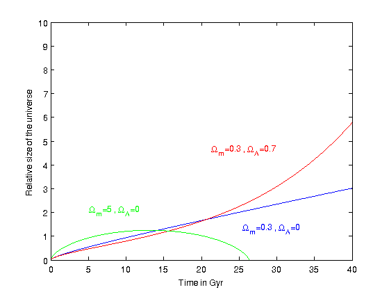

hello, the problem is solved, i had just to add a very small "relative " and "absolute " error as parameters for Matlab "ode" solver. I get the three models (open, closed and euclidean) as it's represented on figure in attachement.
Thanks for all.

Ah, excellent :) Sorry it was such a pain in the butt.
