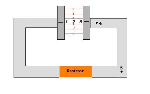

I'm trying to get an idea of what happens in a circuit in terms of electrons electric fields, etc. I know how to solve for basic things (voltage, current, etc) but I never really understood what exactly happens in the wires.
So this is what I think I understand in a simple resistor voltage source circuit. Please correct me if any of it is wrong!
The voltage source creates a potential difference across its terminals. So the conventional positive charges in the wire have a higher potential energy near the positive terminal and this allows them to do work. As they travel through the wires, they dissipate this energy through the resistances until they reach the same level of potential as the negative terminal of the battery. That's my general idea/theory of what happens.
Now moving on to the battery, there is an electric field across it that is caused by the charge inbalance. So point 1, 2 and 3 in the diagram have a different potential and moving a positive charge from those points would cause this charge to gain/lose potential energy. Is this correct?
This is where I get confused:
In the wire connected to the battery I'm trying to figure out if there is an electric field. If there were one, a charge that is at point 4 would reach a lower potential once it is at point 5 (this would be caused just by the fact that it is further away in the electric field (im ignoring the resistance in the wire)). But everytime I quantitatively analyse a circuit, the potential at those two points is the same. So the only explanation that i could think of is that there is no electric field in the wire so there is no potential drop between those two points. But this confused me even more cause if there isn't an electric field, what would cause the motion of electrons in the first place?
If anyone can enlighten me, it would be greatly appreciated!
Hello Sahara,
This is the sort of question which helps us realize how much we take for granted, without really understanding it! As an electrical engineer, I only have ideas about what happens in real-world circuits where wires always have some resistance.
Referring to your circuit, let's call the battery voltage V, the resistor resistance R, and the wiring resistance r. (The path you have labelled 4 to 5 will be part of r). The current I flowing in this circuit will be I = V/(R+r). As r tends towards zero, the current tends towards V/R. Note that however small r gets, there will always be just enough potential drop across it (hence a weak but sufficient field along the path) for this current to flow.
At this point, we need a real Physicist to help us understand what would happen if r actually dropped to zero. That's not just academic, I guess, as there are such things as superconductors. I look forward to hearing more about this: I just hope any explanations will be in relatively simple terms, preferably without recourse to vector calculus.
The circuit you are showing is like a capacitor connected to a battery. Once it is charged up, there is no current hence the potential at point 4 and 5 would be at the same value. Your drawing correctly shows the E-field normal to the plate surfaces. On the connecting wires, the E-field would be normal to it's surface, hence would produce a radial field. To actually calculate the field values, you would need to use Gauss' law. Here is a good visual analysis of how a field between http://hyperphysics.phy-astr.gsu.edu/hbase/electric/elesht.html#c2" would be obtained.

If you have a thick copper wire (maybe 10 mm diameter), it would need to be conducting hundreds of amps to maintain a voltage of even 1 volt across it. Ohms Law always applies to conductors.
So, unless you have such a current flowing, you can say that copper wires are at the same potential on all parts of them.
An electron at 4 in your circuit will not move to 5.
An electron right near the resistor will move into the resistor because a different electron moved from the power source into the conductor.
It is a bit like dropping a brick into a full bucket of water. The water that sloshes over the sides is probably not the water that was displaced.I find the term "potential difference" adequate to describe this sort of circuit.
Neither the positive or negative terminal is superior to the other. It is just the difference between them that matters.If there is a complete circuit external to the power source, current will flow and the external voltage drops will add up to the voltage of the power source.
It is a simple and powerful concept.
