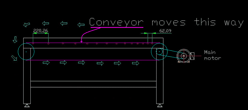

Hi, I am trying to make a conveyor that has a roller expension mechanism.
Please take a look at this drawing.
http://www.flickr.com/photos/46279408@N06/4251882419/sizes/o/
As the drawing shows, you can imagin two supporting beam on each side of rollers as rollers will need to be fixed or assembled to something. I don't know where do they need to be attached for the expension mechanism. But anyway, I need those rollers to be gradually expended as they rotate just like a conveyor and I also need each individual roller to be spined as it moves. How can I possibly do this?

I'm having great trouble understanding your questions.
Please define "expension". Perhaps you mean "extension"? (The only http://www.merriam-webster.com/dictionary/expended" makes no sense in your usage.)
Tell me if I'm interpreting you correctly: As the rollers spin, you want to extend the overall length of the conveyor?
How much extension is required? You might try a chain or belt drive with a movable idler gear taking up the slack.
Is this a design exercise or a practical device you are building? What are the general dimensions and loads?

I'm at a loss... why couldn't you simply mount the rollers directly to the frame in the pitch you depict (the 14 rollers across the top) and then use your motor to drive a conveyor belt which is supported by the rollers?
See attached sketch;

As I understand it, he wants to start with all rollers spaced at 10mm on-center, then gradually expand the spacing to 150mm on-center for all rollers[/].

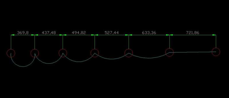

Please take a look at the attached image or below link.
http://www.flickr.com/photos/46279408@N06/4262254146/sizes/l/
The measurement is shown just to indicate that the rollers are expanding.
I've been thinking of connecting those rollers all together by chains like that so that there is a variable spacing from 0mm(min) to let say 150mm(max).
Between the space of each rollers, there must be some mechanism that could separate or regulate the roller pitch. I am sure there must be some method of doing that. I also asked my friends. They said they have seen such mechanism used in some toys.

I hate to say this, pal, but that last picture makes no sense to me. There's something in the rest of your post, though, that sort of tickled a back corner of my brain. I've so far had only a dozen or so beers and a couple of shots of Scotch. Leave me dwell upon the matter over a couple of more brewskies.
edit: Okay... it has something to do with varying diameter toothed wheels driving some sort of chain to regulate the system. I don't think that it can actually work, but I'll think on it a bit.
edit #2: I can't see how to do it with chains, but varying sizes of cogs that grab the axles of the rollers might do it. That's only one more beer and I'm on another Scotch, though, so it's not definitive.

In your latest sketch from post #11;
you show seven rollers with the distance from the first roller to the last equal to
3184.76mm
If the final spacing (after all 'chains' are extended) will be 721.86mm between each roller, then the total distance from the first roller to the last will be equal to
4331.16mm
However; in the sketch contained in your post #3;
http://www.flickr.com/photos/46279408@N06/4252103031/sizes/o/
you show a 'Support beam' length of 2000.00mm ...
If the final spacing between each roller is to be 721.86mm, how do you propose to support the additional 2331.16mm length of the fully expanded conveyor?
Third:
In the same sketch from post #11 you show the following incremental extensions between rollers (numbering rollers from left to right);
roller 3 is 067.68mm further from rolller 2 than roller 2 is from roller 1
roller 4 is 057.34mm further from rolller 3 than roller 3 is from roller 2
roller 5 is 032.62mm further from rolller 4 than roller 4 is from roller 3
roller 6 is 105.92mm further from rolller 5 than roller 5 is from roller 4
roller 7 is 088.50mm further from rolller 6 than roller 6 is from roller 5
This series of increments is not linear, it is not log based. In short; it seems arbitrary... Can you define what your target is?

You should probably make two drawings, one showing the rollers fully compressed, another showing them fully extended.
You will not be able to maintain slack between rollers -- you will need idler gears/rollers for that configuration.
They don't remember it though as it has been a long time since they played with it.:cry:
Pantograph? It would be a little bulky, but it could work.
