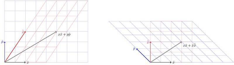

Here's something you might be interested in: hopefully you know that the state of a physical system is described by a point in phase space. For a 1D system, you have a 2D phase space, so the state of the system is described by two coordinates. But you can choose those coordinates to be either [itex]x[/itex] and [itex]\dot{x}[/itex] (the Lagrangian way) or [itex]x[/itex] and [itex]p[/itex] (the Hamiltonian way). Or you could choose some set of generalized coordinates that are combinations of those.
The point is, basically what you're doing by picking coordinates is choosing a basis for a vector space. A particular state of a system corresponds to a vector in the space, which you can express as either
[tex]x\hat{x} + \dot{x}\hat{\dot{x}}[/tex]
(Lagrangian) or
[tex]x\hat{x} + p\hat{p}[/tex]
(Hamiltonian). I'm using letters with hats to denote basis vectors and letters without hats to denote the coordinates. Visually, it looks like this:
(okay, well that's kind of small, but the full-size version is clear)
When you take a partial derivative, like [itex]\frac{\partial}{\partial x}[/itex], physically that corresponds to shifting the state of the system by some infinitesimal amount [itex]\mathrm{d}x[/itex] in the direction of increasing [itex]x[/itex] - that is, the [itex]\hat{x}[/itex] direction, which is to the right in these diagrams. You'll notice that if you take the Lagrangian view (right), [itex]\hat{x}[/itex] and [tex]\hat{\dot{x}}[/tex] are orthogonal, which means that when you adjust the state by that infinitesimal amount in the [itex]\hat{x}[/itex] direction, the [itex]\dot{x}[/itex] coordinate doesn't change at all. But the [itex]p[/itex] coordinate does. This is what it means to say that [itex]x[/itex] and [itex]\dot{x}[/itex] (but not [itex]x[/itex] and [itex]p[/itex]) are the independent variables in the Lagrangian formulation. Conversely, in the Hamiltonian view (on the left), when you adjust the state by [itex]\mathrm{d}x[/itex], the [itex]p[/itex] coordinate doesn't change, but [itex]\dot{x}[/itex] does. Thus [itex]x[/itex] and [itex]p[/itex] are the independent variables in the Hamiltonian formulation. (There are in fact two different meanings of "independent" being thrown around here, so it can easily get confusing!)
