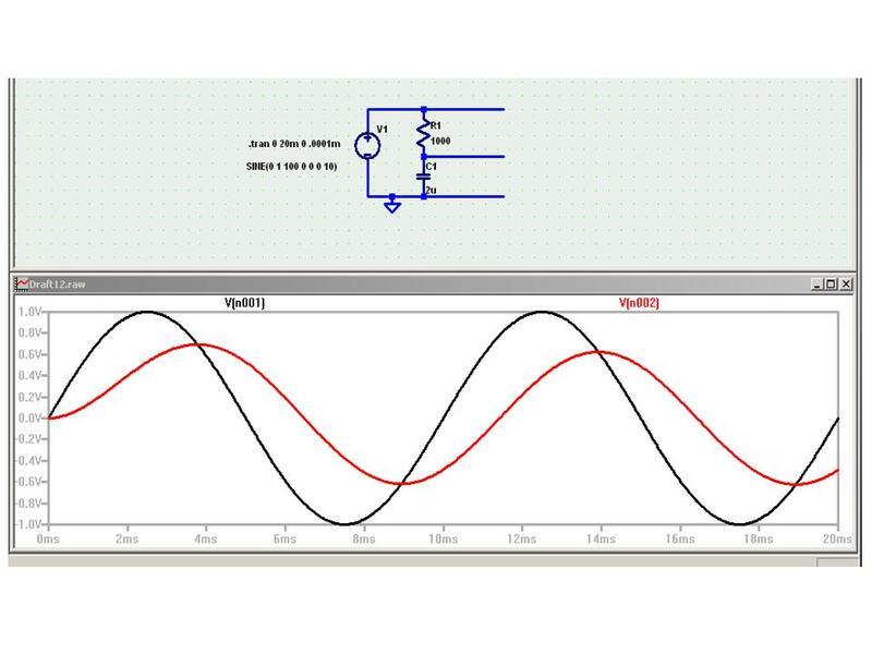

I just need to take a screen shot of the sine wave that would have been produced when i conducted an experiment using an oscilloscope to show the phase angle and i don't have a copy of the one that i used.
You don't get a sine wave from a resistor and a capacitor...
Try LTSpice IV. See attachment.
