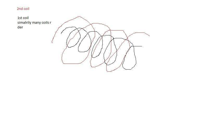

hello all,
i am from electrical background and for a project i need to analyse the flow of oil through a hollow copper tube when the tube is subjected to some amount of heat. the outcome should tell me if the heat will be absorbed by the oil and what would be the stress points when i apply different amount of fluid flow rate. can fluent 6.3.26 be used for this?.if so please let me know how to start, because its totally new to me..
thanks a tonne:)

Well these are coils(round, similar to a suspension used in automobiles) one overlapping the other, I am through with the temp calculations but for presenting it to my boss I need to have a model which is simulated and shows the heat at tube at different points and corresponding stress. When such coils are overlapped the heat of one tube will have effect on others too.
So you have a double pipe serpentine coil?
Are you able to show a picture or print of it?

k..i wil sketch a rough figure.
Hey Matt,
very rough sketch though,but will give you an idea of the system, the two coils are separated by some kind of insulation.

Thanks for the print.
Well, the equation in my first reply is still valid for this system.
If you want to calculate a heat flux, you can "unwrap" the coil and calculate an equivalent straight length of tubing and use that in the heat flux calculation. The only problem there would be with calculating an accurate inside and outside convection coefficient. What is the fluid you are using for heating?
