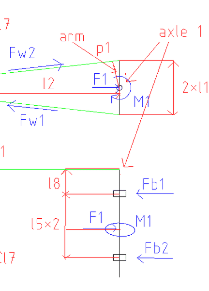

In the steering arrangement below, axle 1 is a circular cross section rod.
It is hold by two bearings.
F1= 476 N
M1 = 15 Nm
Fw2 = 304.75 N, and we know that the moment imposed by Fw2 is equal to M1
l5 = 0.2 m
l8 = 0.1 m
The tensile yielding stress:
[tex]\sigma = 235 Mpa[/tex]
safety factor fs = 1.70
Calculate the radius of the rod.
https://www.physicsforums.com/attachment.php?attachmentid=23596&stc=1&d=1265629087

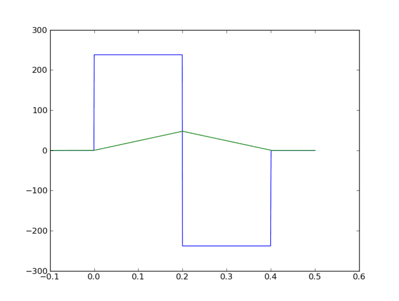

I believe I can solve it for the case when I neglect M1 and Fw2:
[tex]$ \\<br /> $ Fb_{1} = Fb_{2} = F_{1}/2 \\<br /> Fb_{1}=\frac{1}{2} F_{1}=238 N \\<br /> \lvert{Fb_{1}}\rvert=238 N \\<br /> Fb_{2}=\frac{1}{2} F_{1}=238 N \\<br /> \lvert{Fb_{2}}\rvert=238 N \\<br /> $ shear in axle 1 $ \\<br /> shear = \begin{cases} 0 & \text{for}\: x < 0 \\Fb_{1} & \text{for}\: \operatorname{And}\left(0 \leq x,x < l_{5}\right) \\Fb_{1} - F_{1} & \text{for}\: \operatorname{And}\left(l_{5} \leq x,x < 2 l_{5},0 \leq x\right) \\\operatorname{And}\left(2 l_{5} \leq x,l_{5} \leq x,0 \leq x\right) & \text{for}\: Fb_{1} + Fb_{2} - F_{1} \end{cases} \\<br /> moment = \begin{cases} 0 & \text{for}\: x < 0 \\Fb_{1} x & \text{for}\: \operatorname{And}\left(0 \leq x,x < 0.2 m\right) \\x \left(Fb_{1} - F_{1}\right) + 0.2 F_{1} m & \text{for}\: \operatorname{And}\left(0.2 m \leq x,x < 0.4 m\right) \\0.4 m \leq x & \text{for}\: x \left(Fb_{1} + Fb_{2} - F_{1}\right) + 0.2 F_{1} m - 0.4 Fb_{2} m \end{cases} \\[/tex]
maximum bending moment in axle 1
[tex] M_{a1}=Fb_{1} l_{5}=47.6 N m \\<br /> \lvert{M_{a1}}\rvert=47.6 N m \\[/tex]
Euler-Bernoulli beam equation with safety factor:
[tex] \frac{\sigma}{fs} = \frac{M y}{Ix} \\[/tex]

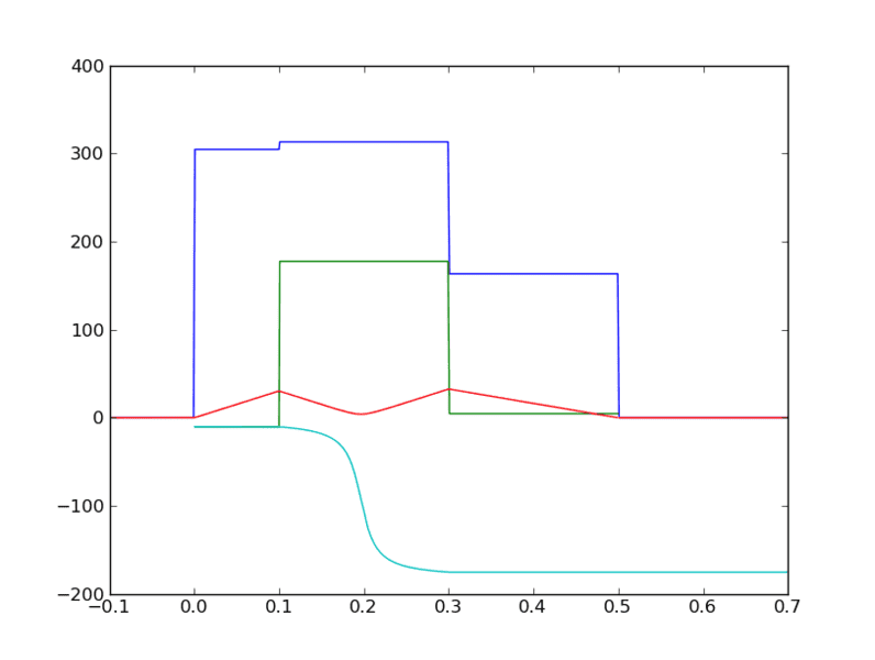

Here is my attempt at calculating tensile stress in the way I have outlined above, and the presumably correct calculation for shear stress.
How should I combine the two? I was thinking for a moment that tensile stress is normal to shear stress, so maybe they are really independent, but I don't believe in that. I just can't imagine a rod bent nearly to its limits, and withstanding the same twisting force as without bend.

shear in axle 1
[tex]shear = \begin{cases} 0 & \text{for}\: x < 0 \\Fw_{2} & \text{for}\: \operatorname{And}\left(0 \leq x,x < l_{8}\right) \\Fb_{1} + Fw_{2} & \text{for}\: \operatorname{And}\left(l_{8} \leq x,x < l_{5} + l_{8},0 \leq x\right) \\F_{1} + Fb_{1} + Fw_{2} & \text{for}\: \operatorname{And}\left(l_{5} + l_{8} \leq x,x < l_{8} + 2 l_{5},l_{8} \leq x,0 \leq x\right) \\\operatorname{And}\left(l_{8} + 2 l_{5} \leq x,l_{5} + l_{8} \leq x,l_{8} \leq x,0 \leq x\right) & \text{for}\: F_{1} + Fb_{1} + Fb_{2} + Fw_{2} \end{cases}[/tex]
[tex]moment = \begin{cases} 0 & \text{for}\: x < 0 \\Fw_{2} x & \text{for}\: \operatorname{And}\left(0 \leq x,x < l_{8}\right) \\Fw_{2} l_{8} + x \left(Fb_{1} + Fw_{2}\right) - l_{8} \left(Fb_{1} + Fw_{2}\right) & \text{for}\: \operatorname{And}\left(l_{8} \leq x,x < l_{5} + l_{8},0 \leq x\right) \\Fw_{2} l_{8} + x \left(F_{1} + Fb_{1} + Fw_{2}\right) + \left(Fb_{1} + Fw_{2}\right) \left(l_{5} + l_{8}\right) - l_{8} \left(Fb_{1} + Fw_{2}\right) - \left(l_{5} + l_{8}\right) \left(F_{1} + Fb_{1} + Fw_{2}\right) & \text{for}\: \operatorname{And}\left(l_{5} + l_{8} \leq x,x < l_{8} + 2 l_{5},l_{8} \leq x,0 \leq x\right) \\\operatorname{And}\left(l_{8} + 2 l_{5} \leq x,l_{5} + l_{8} \leq x,l_{8} \leq x,0 \leq x\right) & \text{for}\: Fw_{2} l_{8} + x \left(F_{1} + Fb_{1} + Fb_{2} + Fw_{2}\right) + \left(Fb_{1} + Fw_{2}\right) \left(l_{5} + l_{8}\right) + \left(l_{8} + 2 l_{5}\right) \left(F_{1} + Fb_{1} + Fw_{2}\right) - l_{8} \left(Fb_{1} + Fw_{2}\right) - \left(l_{5} + l_{8}\right) \left(F_{1} + Fb_{1} + Fw_{2}\right) - \left(l_{8} + 2 l_{5}\right) \left(F_{1} + Fb_{1} + Fb_{2} + Fw_{2}\right) \end{cases}[/tex]
blue is magnitude of shear, green is angle of shear in degrees, red is magnitude of moment, cyan or whatnot is angle of moment
we can see that maximum of moment is at 0.3 = l_{5} + l_{8}
[tex]M_{a1}=\lvert{Fb_{1} l_{5} + Fw_{2} l_{5} + Fw_{2} l_{8}}\rvert=32.7098569990448 N m[/tex]
It appears you have one or more mistakes. E.g. (for example), in your "moments about Fb1" equation in post 4, because you are using counterclockwise positive (which is good), the F1*L5 term should be added, not subtracted. Likewise, in your "moments about Fb2" equation, the F1*L5 term should be subtracted, not added. See if you can go ahead and implement these corrections. These are the only two equations I looked at, for now, because I have very limited time, at the moment. I will try to look at this again over the next several days, when I have time.

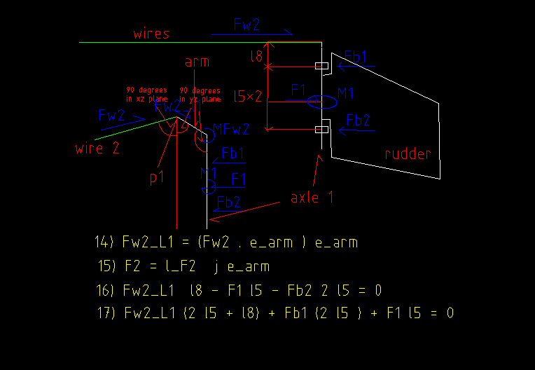

The drawing contains the profile view of the rod, and a perspective view of the same.
I have noted some orthogonals to make things clearer.
Discovered a mistake. I think the bending component of Fw2 is the one orthogonal to the rod, that is
paralell to the arm, that is
[tex](Fw2 \cdot e_{arm} ) e_{arm}[/tex] where e_arm is a unit vector in the direction of the arm.
I don't see however why the sign of the moment by F1 should be negated.
I have depicted F1 on the other side in the perspective view to underline that I think that only the point of
attack is significant with F1. As it is a vector in the plane orthogonal to the rod, its direction is encoded in
the vector (orthogonal to e_arm). This is why I think the "push vs pull" issue does not arise the same way it would with a 2 dimensional case with a scalar force.
What the problem with this line of thought?
instead of F2, read F1 and l_F2 -> l_F1 in the picture above
Both components of Fw2, parallel and perpendicular to the rudder lever arm, cause bending in axle 1. However, the axle 1 bending moment about the steering system global x-axis currently increases the axle 1 moment by only 0.03 % (relative to the moment about the global y axis).
F1 should be drawn pointing toward the rear of the boat. If you draw F1 in the opposite direction, then you must input a negative value, F1 = -476 N.
Using F1 = 476 N, alpha = 60 deg, and Fw2 = 255.02 N, when you work the problem correctly, the answer for the Ma1 bending moment case should be an axle 1 radius of r1 = 8.220 mm. You can multiply this answer by 1.008 to account for the M1 torsional shear stress case, thus obtaining r1 = 8.286 mm.

Yes, Fw2 is backwards in your last diagram. I forgot to mention that. Reverse the direction of Fw2 in your last diagram. F1 is backwards in the perspective view, but is correct in the profile view. Reverse the direction of F1 in the perspective view of your last diagram.
I would recommend to not worry about the 0.8 %. It is too small to spend time on; almost negligible for axle 1. Just multiply your answer by 1.008. It is not computed in any way like what you have imagined and posted.
