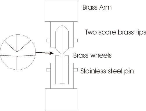

This worked for me when I needed to weld two pieces of thin SS together.
I bought a spot welder on ebay and then instead of the two points coming together to "spot weld". I made two rollers of brass to attach to the ends.. One was beveled to a narrow wedge and the other was flat.
I overlapped the two pieces of SS and secured with masking tape so I could "pull" the sheets through the rollers.
Takes a little fudging with the current of the spot welder and the feed rate but it can work well.

Shell, I was wondering if you have some pictures of your spot welder rollers by any chance. This might be a good way for me to do it since I have a spot welder.
Hi leoflc,
Wish I had some pictures to send you but I don't. I did a quick drawing. Hope it helps.
Shell

Just wondering, is there a reason to use SS pins?
leoflc said:
Thank you very much!
You're welcome. Brass and SS make a great bearing plus I had both laying around in the shop.
