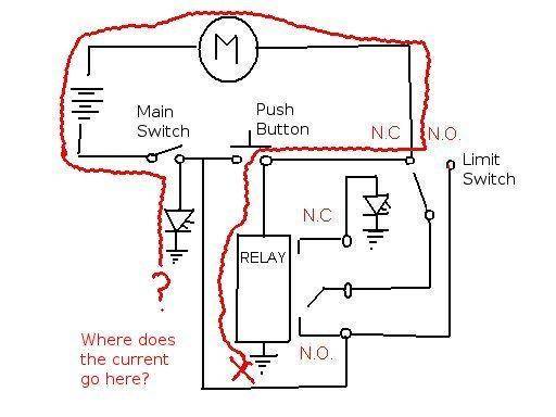

I am just learning about this and don't know if I am doing it right.
I need to turn my car on with a push button switch and have it turn off when it hits another switch on the axle and turn on a light when the motor turns off.
I made the circuit shown in my drawing but I have to hold down the push button switch for a few seconds before the relay will stay seated. I need the car to go the second the switch is pushed down.
My Dad thinks I need to add a capacitor in there but I had know idea until today what a capacitor was or how to add it to my electrical drawing.
Were only allowed to use Wires Switches, Mechanical relays, Resistors, capacitors, Motors. battery's 4.8vdc max

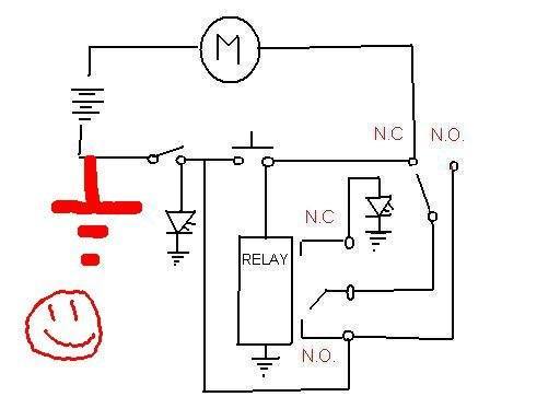

The relay has a little coil in it that stores energy. It looks like it's normally "on" and it divides the voltage so that the motor can't run. When you push the button and short the relay, it needs a way to discharge that energy and let the switch close. It looks like you want it to be connected to some kind of ground but the ground is not connected to the negative terminal of the battery. I think the problem is that your "ground" actually goes through a diode to return back to the negative terminal of the battery. It makes it take a long time to discharge the coil's energy in the relay. Try this:
If I'm reading your design right, connecting the negative terminal to ground may cause the motor to start running before you push the start button.

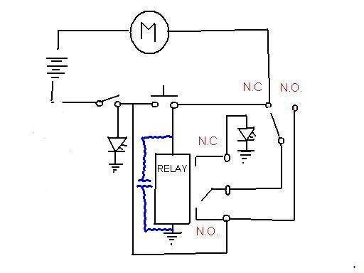

In that case, you could try option 2: Put a really big capacitor across the relay like this:
No guarantees but it may let the coil dump some of it's energy right away so that the switch closes quicker.
Those are both just attempts at a quick fix.

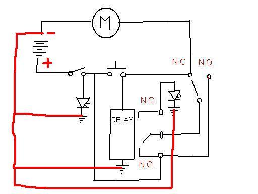

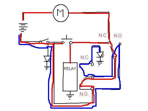

Here is another drawing, red shows how I think it should work when the momentary switch is pressed and the blue shows how it should work when the other switch is pressed.
I am using a 5v relay when I should be using a 3v relay but I don't know where to get one.
The relay does trip when I push the switch but turns right back off unless I hold the momentary switch for a few seconds.
Someone told me the motor is taking into much current when it starts that there's not enough yo hold the relay until the motor is going full speed, but I don't get that part.

Take a look at this:
I'm not sure that you even have it hooked up like this diagram shows. However, if the relay is really hooked up to ground, it is going to be on before you press the push button. The only thing keeping the motor from running is some kind of voltage divider when the relay is on. The motor doesn't actually have to turn in order to let current pass through it and into the relay. When you push the button, you are shorting the relay and turning it off so that the motor gets enough voltage to start spinning. However, you have to hold it down long enough to let it discharge fully. This is the best I can tell from looking at your design.
I'll help you out a bit. First, I don't know if you're in the U.S. but you can get a 3V relay at radio shack. Second, here's how I would do what you want.
I purposefully left out the limit switch. I'll let you figure out where it should go.

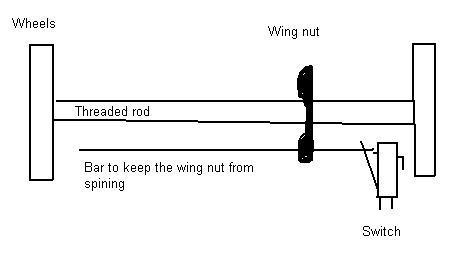

I really only need one LED so I can see when the axle has hit the limit switch, the axle of the car is a threaded rod with a wing nut on it. This way I can turn the wheels by hand and see when the limit switch has been pressed and then calculate how many times I need to turn the wheels backwards to make the car go what ever distance the judge says it needs to go. It is either 5, 10 or 15 meters.

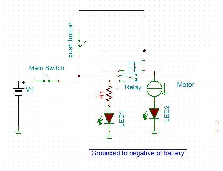

This may be a better way of doing it:
http://dl.dropbox.com/u/4222062/motor%20switch.PNG
LED1 should light when the batteries are put in. You can put a switch in series with the batteries if you like, or just omit LED1.
Pushing the start switch will cause the relay to pull in and start the motor.
The relay contact will keep power on the motor and the relay coil, and light the RHS LED. LED1 will turn off when the motor is running.
Pressing the stop switch will remove power from the relay coil, stopping the motor.
The resistors in series with the LEDs should be about 100 ohms.

Your delay problem with the relay is odd. Perhpas your relay coil requires more current than your batteries supply. If your power sources is borderline, you may need to change it. Perhaps the voltage you supply across the relay is less than the specified voltage. This will also cause it to be slow in response. The delay for most relays are measured in miliseconds. Therefore there is something wrong with your relay or the power you are supplying to it.
