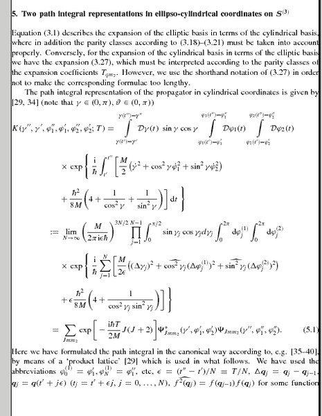

Quantum mechanics has the same form as 1+0 dimensional QFT. I found the propagator in cylindrical coordinates in a paper of Grosche
http://www.iop.org/EJ/abstract/0305-4470/30/5/025"
(see also the attachment)
I think one should only add the [tex]\int d^3 x[/tex] in the exponential.
The problem is that it's a quite difficult expression ;)

Sunset -> Thanks for the help... but it again doesn't help :( I know QM is 1+ 0 D QFT, but the one spatial dimension makes a world of difference. The QM propagator in cylindrical coordinates is not the same as the field theoretical propagator on the cylinder. When I say "on the cylinder" I mean that the spacetime I'm living on is a cylinder, i.e. [tex]\mathbb{R}\times\mathbb{S}[/tex]. So it's 2D. It seems to me that the expression in your attachement is the propagator for a problem in QM with axial symmetry in 3 spatial dimension (judging by what I'm guessing are spehrical harmonics in the last line.) Basically what I'm looking for is an explicit expression for
[tex] \int d \omega \sum _{p \in \mathbb{Z}} \frac{e^{i \omega t - i p x}}{- \omega^2 + p^2 + m^2 - i \epsilon}[/tex]
which is the inverse Fourier transform of the Feynamn propagator in momentum space. (M is a positive constant and [tex]\epsilon[/tex] is a small positive infinitesimal.) In Minkowski space the sum would be another integral and one can find that expression in books. But with the sum, I was not able to find it anywhere... I need it just for "completness" as my supervisor wants to put in into the paper we're workin on.

Oh ok, thought you were talking about fields in cylindrical coordinates. Since you're talking about space-time in cylindrical coordinates, my atachement is of course of no use for you.
Best regards
