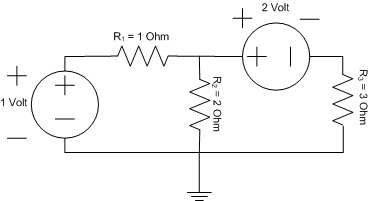

I've added some attachments that you can click on below for reference.
The first attachment shows an example circuit.
The next two attachments show different ways that we've going to solve this problem, using different current loops (same circuit, just different current loops). Assume that we are solving for the voltage across the 3 Ohm resistor.

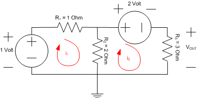

Solution 1:
Please refer to second attachment, where there are two small loops. We sum together the voltages going around each loop. Since there are two current loops there are two equations:
[tex](-1 V) + (1 \Omega)i_1 + (2 \Omega)(i_1 - i_2) = 0[/tex]
[tex](2 V) + (3 \Omega)i_2 + (2 \Omega)(i_2 - i_1) = 0[/tex]
We can re-write each simultaneous equation, simplifying things somewhat,
[tex](1 V) = (1 \Omega)i_1 + (2 \Omega)i_1 - (2 \Omega)i_2[/tex]
[tex](-2 V) = (3 \Omega)i_2 + (2 \Omega)i_2 - (2 \Omega)i_1[/tex]
Factor the [tex]i_1s[/tex] in the first equation and the [tex]i_2s[/tex] in the second equation,
[tex](1 V) = (3 \Omega)i_1 - (2 \Omega)i_2[/tex]
[tex](-2 V) = -(2 \Omega)i_1 + (5 \Omega)i_2[/tex]
From here, there are a few ways we can go to solve this pair of simultaneous equations. There's linear algebra, substitution, and what I'm going to use here. We're really interested in [tex]i_2[/tex] since that will give us the voltage across R3. But we need to eliminate [tex]i_1[/tex] somehow. So let's multiply everything in the top equation by 2 and everything in the bottom equation by 3, in anticipation of adding the two equations together later.
[tex](2 V) = (6 \Omega)i_1 - (4 \Omega)i_2[/tex]
[tex](-6 V) = -(6 \Omega)i_1 + (15 \Omega)i_2[/tex]
Now add them together.
[tex](-4 V) = (11 \Omega)i_2[/tex]
or simply [tex]i_2 = -\frac{4}{11} A[/tex]
which gives us
[tex]V_{OUT} = (3 \Omega)(-\frac{4}{11} A) = -\frac{12}{11} V[/tex]
