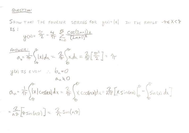

Since I don't know how to insert equations into a message here, I've scanned both the problem and my attempt at a solution. Where I run into problems is how to find an. I'm not completely sure how to treat that integral and was hoping somebody could nudge me in the proper direction.
Thanks!
Andrew

You messed up writing down the second integral when you integrated by parts, specifically, you dropped the n in the argument. Otherwise, you look like you're on the right track.
Thanks! I wrote that in a bit of a rush but so long as the idea is right I'll keep working with it.
