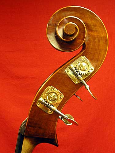

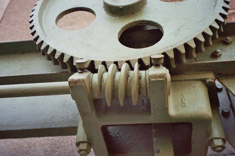

You interpreted my question right, but I'm still a bit confused. Can a self locking worm drive be turned *at the worm* both backwards and forwards?
Like these pictures, for example.
