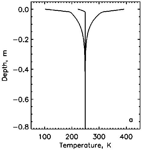

Here's a good picture of what goes on, from Vasavada et al (1999) "Near-Surface Temperatures on Mercury and the Moon and the Stability of Polar Ice Deposits", in Icarus vol 141, pp 179–193 (http://dx.doi.org/10.1006/icar.1999.6175 ; unfortunately full text needs a subscription.)
This is showing minimum, maximum and mean temperatures on the Moon with depth, based on a computational model taking into account the thermodynamic properties of surface materials, and showing the kink in mean temperature right at the top 2 cm. The physical cause of this the difference between surface and subsurface temperatures -- temperature dependent conduction -- is physically a different thing from the atmospheric greenhouse effect that means Earth's surface is so much warmer than the effective radiating temperature.
Another good basic reference is "Lunar sourcebook: a user's guide to the moon" by Grant Heiken, David Vaniman, Bevan M. French, (Cambridge Uni Press 1991). This is widely used, and it says of the information from Apollo missions (on page 38):
3.6.2 Conclusions.
The upper 1 to 2 cm of lunar regolith must have extremely low thermal conductivities (1.5 x 10-5 W/cm2), with conductivity increase 5 to 7 times at a depth of 2cm. At the Apollo sites, mean temperatures 35 cm below the lunar surface are 40 to 45 K above those at the surface. [...] It is noteworthy that an insulating blanket of only about 30cm of regolith is sufficient to dampen out the ~280 K lunar surface temperature fluctuation to +/- 3K variation. [...]​
The physical reason is given on page 34:
Langseth and Keihm (1977) describe a large difference in mean temperature (i.e., the temperature averaged over a complete day-night cycle) just below the lunar surface. At the Apollo 15 site, the mean temperature at a depth of 35 cm is 45 K higher than that of the surface; at the Apollo 17 site, the difference is 40K. The increase in the mean temperature is related mostly to the temperature dependence of thermal conductivity of the topmost 1 to 2cm of lunar soil.​
The measurements by Apollo 15 and 17 were 252K and 255K respectively at 1m depth, which implies surface means of 207 and 205K respectively. This is rather less than the value for a global mean you suggest, but that might just be because of the particular landing sites; I am not sure.
