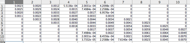

I attached 3 files. one picture of the reduced A matrix, with only the 6 highest values of the matrix. one of the b vector. And the data files which include the full A matrix, the reduced and the b vector.

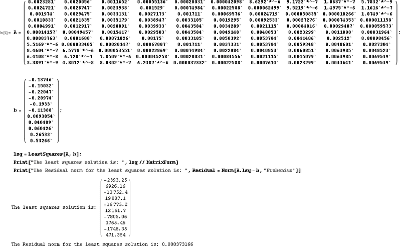

I hope I got all the numbers into Mathematica correctly. I calculated a least squares solution which is shown in the first image. You might check it against what Matlab gives. Also give a quick look over at the data in my image.

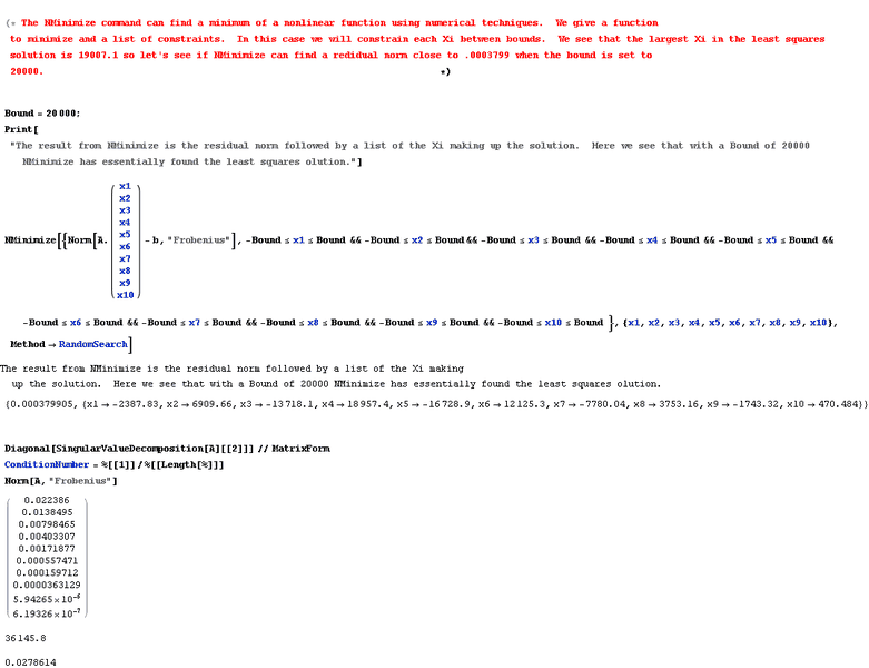

To solve this system with constraints, I used a command "NMinimize" in Mathematica. It can minimize nonlinear functions.
In the second image you can see in the NMinimize command that I have an expression for the norm of the residual. I calculated it as the matrix product of A times a vector of Xi minus the vector b, then took the Frobenius norm. There's a variable named Bound and you can see the 10 constraints of the Xi to be between -Bound and +Bound. The result of this command is a list in curly braces {}. The first number is the norm of the residual, followed by a list of the Xi values.
Looking at the least squares solution from the first image, we see that the largest Xi, namely X4, is 19007.1. One would think that if we allow NMinimize to search for a minimum with Bound set to slightly larger than X4, it should find a solution (essentially) equal to the least squares solution. This is what it did.

You posted this in the homework help forum; is this actually a homework problem? It looks like a curve fitting problem to me. I calculated the condition number of your A matrix. It's shown in the second image as the ratio of the largest to the smallest singular value, a fairly large condition number of about 36000, even though the matrix itself has a fairly small norm.
If this is a curve fitting problem, or perhaps a multiple regression problem, you may get better results with a reduced model.

Thank you for your efforts, I really appreciate it. And essentially it's not a 100% homework problem. It's just a problem I'm trying to solve. Your numbers are correct and your solution for the least square approximation is +- my MATLAB solution. Your last image looks very promising, with restrictions to the solution, I will have a look at that solution.
