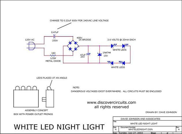

im trying to wire 100 leds into my playstation using my ps3's 120vac power supply I am new to this so I am not quite sure how to do it but i found a night light wiring diagram and was wondering what i had to do to modify it to fit my needs i attached it to this post i appreciate any help thanks

That circuit is crazy unsafe. Thread locked. PM me to discuss what you want to do, and maybe we can re-open the thread. Lordy.
EDIT -- Okay, in the hands of an experienced designer, this could be safe-ish with the right additions. But in the hands of somebody who says "I'm not sure what I'm doing", that's the crazy part.
