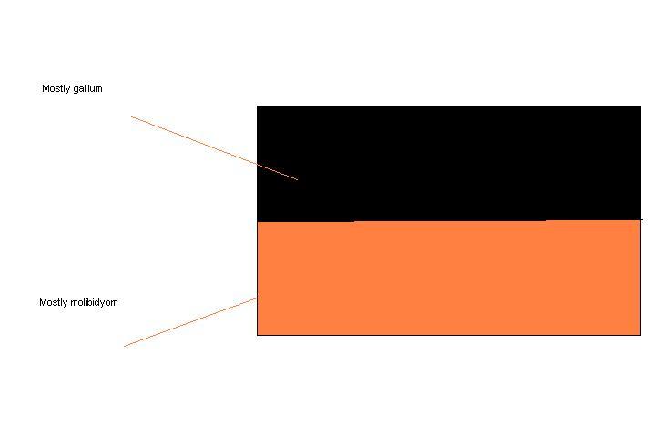

I am trying to make an metallic alloy consist of gallium and Molybdenum but it is all ways form in non-consist[homogeneous ] alloy… look to the attachment but in the market there is one … how I make it?
Do I need to change the Temperature … or something else
Alloying very light or low melting point metals with heavier or high melting metals is quite challenging, and conventional pouring/casting won't work. The higher melting metal freezes first, and if denser would sink in the melt and exclude the low melting metal.
One method is to use levitation melting followed by a rapid quench. An alternative would involve a powdered metal approach with hot-isostatic pressure.
Does it have to be pure Mo-Ga? and in what proportions?
