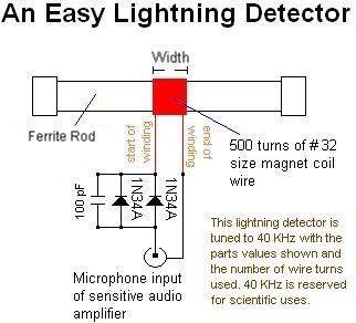

I think there are devices/equipment to detect lightning strikes. But how does the device actually work? Lightning strike randomly to the ground and we have no idea where it will hit right?
Lightning often strikes repeatedly in higher locations (hills, mountains) and tall objects such as towers and trees (although a tree may not be good for many hits). Like any short circuit, it constantly seeks the nearest discharge path.
Detecting lightning activity and pinpointing a strike's exact location is two different things though. You can detect lightning activity with an AM radio, and I've seen plans on the internet for a simple "lightning detector". More sensitive equipment can likely differentiate between "cloud-cloud", and "cloud-ground" strikes.
Determining an exact strike location may require sensors scattered about to pick up enough info for triangulation though, not real sure about this.
