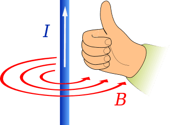

just out of curiosity, would the arc itself generate a field?
Yes, but a magnetic field in the form of a circular pattern concentric with the arc. This is no different to a current flowing in a wire.
that was my guess, dvchench, but for what I'm doing i hope vk6kro is right.
thanks dvchench, that pretty much confirms what i thought.
...and vk6kro
