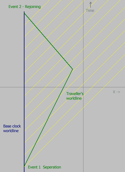

In the diagram I've attached, which is the basic traveller scenario, you can see that any worldline that goes from event 1 to event 2 must receive the same number of synch pulses from the base clock. A realistic worldline must lean less than 45 deg from the time axis at all times. Try sketching a worldline that breaks that rule.
I don't think there's any way to estimate the base-clock's rate except by using synch pulses, because seeing a clock running is hard thing to do if the clock is a long way off.
I can't see what you're trying to demonstrate with this thought experiment, I hope you can be convinced that the weird things you suggest can't happen.

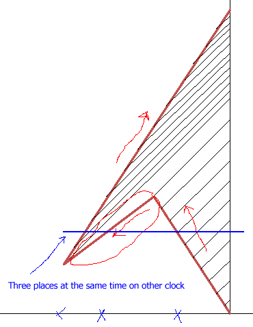

So, I'm still trying to put all this together. Please let me know if I've got anything wrong. In the twin paradox, would the attached diagram, in which the "traveling twin" occupies the vertical axis, accurately depict the transmission of light pulses from the stationary twin to the traveling twin, with the following three things happening as a result of the "turnaround," all from viewpoint of the traveling twin:
1. The incoming distance traveled by the incoming beams "jumps" higher;
2. The time it takes for the incoming beams to reach the traveling twin "jumps" higher;
3. "Present" or "now" at the stationary twin's location "jumps" forward.
And these effects, in a sense, cancel each other out, preserving the continuity (but not the rate), of the incoming light pulses. In other words, despite the fact that these three things "jump" at turnaround, the stationary twin's clock, as observed by the traveling twin, would not "jump" at all, but merely go from appearing to tick slowly to appearing to tick quickly.

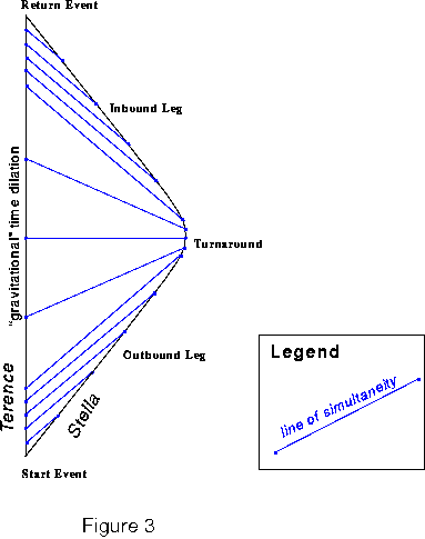

p.s. twinparadox2 includes my guess as to what the traveling twin's lines of simultaneity might look like, before and after the turnaround (in blue).
Hi,
I looked at the picture, but one twin travels backwards in time so it's not possible. Apart from that, you've got the right idea.
(unless I misunderstood the diagram ).

Mentz114 said:
Hi,
Here's my understanding: to the the traveling twin, the stationary twin does move back in time. This is just like in the example that Jesse explained above - If I suddenly decelerated when I struck clock 1, then clock 2 would move back in time (from year 16 to year 0).
However, this takes place outside my lightcone, so it doesn't violate the laws of SR. The traveling twin doesn't actually see the stationary twin move back in time (he doesn't see the stationary twin's clocks move in reverse), because of the corresponding increase in the distance that light has traveled.
Let me know if you think this is wrong, and why.
The problem is that the phrase "to the traveling twin" isn't very well-defined--as you pointed out, you're not talking about what the traveling twin actually sees visually. Are you talking about what happens in a non-inertial frame where the traveling twin remains at a constant position both before and after acceleration? Unlike with inertial frames, there isn't a single unique way to construct a rest frame for a non-inertial observer, you could construct many different types of coordinate systems in which this observer was at rest with different opinions about simultaneity, none would be preferred over any other by the laws of physics. If you specify that you want a non-inertial frame where the definition of simultaneity and distance at each point on the non-inertial observer's worldline should match up with the definition of simultaneity and distance in his instantaneous co-moving inertial frame at that moment, then it's true that if you decelerated when you struck clock 1, clock 2 would move backwards from 16 to 0. Still this is basically an arbitrary matter of choice, there's no physical reason that compels you to define things this way.
And if you do want to give the traveling twin in the twin paradox a non-inertial frame whose definition of simultaneity always matches up with his instantaneous co-moving inertial frame, then in the standard version of the twin paradox he should actually see the inertial twin's clock jump forward, not back. The last section of this twin paradox FAQ has a diagram:
I've said my piece - your space-time diagram has one backwards in time segment. The observer on this leg will see other clocks running backwards.
I think it's consistent. When I decelerate after striking clock 1, I'm accelerating away from clock 2. The traveling twin, during "turnaround" is accelerating toward the stationary twin. So I think it makes sense that, to me, time at clock 2 would move backward, and, to the traveling twin, time at the stationary twin's location would move forward.
As far giving an accelerating observer a non-inertial frame whose definition of simultaneity always matches up with his instantaneous co-moving inertial frame, I think that's what happening in the animation below (from http://en.wikipedia.org/wiki/Lorentz_transformation). To me, it looks like it is possible for time to move "backwards" (i.e., in the diagram, events outside the lightcone move "up," from the past to the future). However, no event passes the lightcone boundary twice (it's not possible to "see" a clock move backward).
