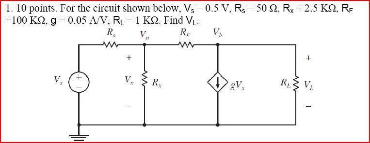

Voltage dependent current source? Please help
Attached the problem.
Tried to Use KCL, not sure what else to do.

Welcome to the PF. Show us your work so far. Show us your KCL equations.
I tried KCL at Va: (Vs-Va)/Rs+(Vb-Va)/100000+(Vx-Va)/2500=0
and KCL at Vb: (VL-VB)/1000-.05Vx+(Va-Vb)/100000=0,
So i have 2 equations and 4 variables assuming my work so far is correct, I am not positive on the sign conventions. Should I be using KVL, or Mesh analysis instead or in addition?
KCL should work fine. Look at the circuit again, and see that Va = Vx, and Vb = VL.
Also, be careful with your sign conventions -- either sum the currents leaving a node or going into it. I believe you were mixing signs in the first line (but the fact that Va = Vx kind of muddies that sign error anyway). I personally prefer to sum the currents leaving each node, but that's just me.
