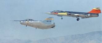

Creator said:
There is lower pressure above the wing due to the curvature of the surface causing the air to move faster over the upper surface.
This is "hump theory" and it's not true. Here's an example of a M2-F2 glider with the hump on the bottom, it glided just fine.
