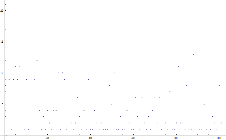

I found the first 100 terms in the continued fraction of [itex]\beta[/itex] (not the number you suggested):
Code:
{0,9,1,9,11,9,11,90,1,9,1,90,110,9,12,4,1,3,1,4,2,1,4,4,10,1,10,9,1,907,2,1,2,6,3,1,4,1,9,1,1,4,2,1,2,1,1,1,8,5,10,1,1,3,1,1,4,2,1,1,6,3,1,6,2,1,3,1,4,6,2,6,1,39,2,1,7,1,1,2,11,2,2,1,8,1,1,13,28,89,1,1,5,1,26,1,3,2,1,8,2}

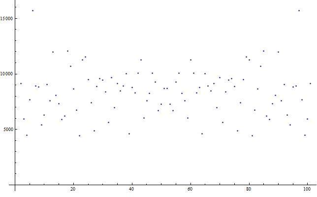

If you make a scatter plot of these values, you can't see any regularity:
I tried to see if there are some hidden periodicities in the sequence by performing the discrete Fourier transform. Here is the power spectrum:
It looks pretty much like white noise to me.
