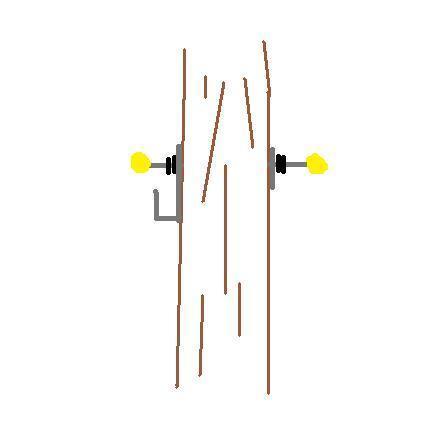

Yea every time the swing comes outward its going to pull that bracket with it. I would consider putting a bolt long enough to go completely through the tree with enough extrusion at either end to allow for future tree growth. Fasten on the side opposite the bracket it with a large enough washer that it cannot pull through the tree and 2 bolts. 2 bolts allow you go tighten them against each other to lock them in place. If you want an added safety factor cap the ends of the bolts with some rebar capping. This is used in construction almost everywhere to prevent cuts and scrapes and prevent a potential falling worker from impalement. Check out my attached ms paint sketch.
Every year you can loosen the bolts off a couple mm or however needed to allow the tree to grow. You see trees growing around old pieces of metal or decks all the time so I figure after a couple years of growth the tree will tighten up around the bolt like its not even there. You could even spray the hole around the bolt with a pruning agent to prevent bugs from entering the hole.

The plan has been to run the bolt through the tree and use broad washers on both ends. One option would be using an eye-bolt or eye-nut, and cabling the far end (with turnbuckle) to another branch (see picture). A bolt all the way through is much less of a problem for the tree than two on the same side, and it's much like what is done when a huge old tree is cabled to support heavy branches. The resulting support isn't the same as two supports on the swing beam, but it may help.
I'm looking at a 3/4" or 7/8" bolt. Also at getting the bracket made with the open top of the J closed (would this be called a "d" bracket?).
