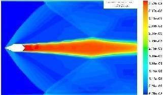

Thanks for your reply. I was searching for an answer before doing any numerical simulation. I was pretending to employ Euler equations (without the diffusion terms) in order to describe the flow. Euler equations assume that diffusion and heat transfer are negligible compared with convection phenomena. This is the same thing that saying mixing layer has a negligible thickness compared with the longitudinal variations at #Mach>>1.

Anyway, I was trying to program some simulation of this flow in Matlab. This is very interesting in supersonic combustion (have you ever heard about Scramjet engine?). If not, see the attached file below. I've found it in the web. It's a supersonic flame simulated with Fluent.
