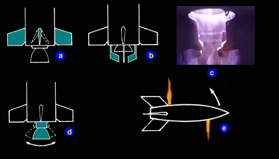

Let me give you another example. Imagine a rocket in space. If the astronauts want to rotate the rocket, they will turn on two opposite reaction control thrusters with a distance d between them (image e in the following figure).
If one thruster is stronger than the other, then the resultant force is not zero, so there will be a rotation about the CG, but there will also be a translation of the CG as well. No matter where the thrusters are wrt the CG, the acceleration (in translation) will be the same, but the angular acceleration about the CG will depend on the position of the thrusters wrt the CG. This is a moment.
If the two thrusters have the same force, the resultant force is zero with a moment F X d setting the rocket in pure rotation, no matter where they are wrt the CG. This moment, we refer to it as torque.
Now imagine that rocket back on Earth, held rigidly by a shaft passing through its CG and this shaft held rigidly by a vertical pole aligned with the CG, such that nothing can move. Assume the thrusters are aligned with the vertical pole. Let's apply the same forces.
In the first case (one thruster stronger than the other), there will be a compression (or tension) force in the vertical pole due to the resultant force of the thrusters. There will also be a bending moment applied to that pole. The moment strength will depend on the position of the thrusters wrt the pole.
In the second case, there will be no vertical force in the pole, since the resultant force of the thrusters is zero. There will also be no bending moment either. There will only be a torque applied to the shaft, with magnitude F X d, no matter where the thrusters are wrt the shaft.
