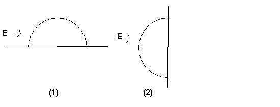

I am messed up with the concept of projection of area of different surfaces and flux through different surfaces...
Please someone explain it with some examples such as -
1. Hemisphere (I AM GETTING --- FLUX = E pi r^2 ) PLEASE CONFIRM
2. Frustum (not getting)
3. Cone (not getting)
we have to find flux through all these surfaces (The field E is uniform)
sorry about my English ...

3.
this is your Diagram:
(N.B. the dots in the cone are just to give it shape)
E
-->./...\ <---- cone
-->/____\___________ <- table
E
-->./..! <---- half cone
-->/__! ___________ <- table
you have a triangle so the flux is :(surface of triangle) * (E) = ...
you can work out the same with othe problems .
thanks for ur reply
but can u please explain it for frustum and hemisphere
not getting the answer in case of frustum
and please confirm hemisphere one
thanks
What is the orientation of the hemisphere ?
case 1 :
flux = (surface of semi Circle )*E
or
case 2 :
flux = (surface of a Circle )*E
