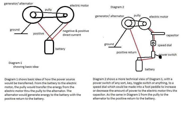

im doing a simple home made project. wanting to know how i can use 2 electric motors to restore juice to the battery. i have 1 motor as my power source, with another as a generator, running on a pully system with a rubber band. I know i could use a gear system, but I am lacking funds for gears that i can get at a hobby shop.
How would i be able to use the 2nd motor as a generator to power the battery instead of the battery powering both electric motors?
Im familiar with automechanics on a basic scale, but not towards it's electronic components, like the battery to the starter to the alternator back to the battery. Some how doing it on a small scale using 2 electric motors there's only a positive and a negetive wires from the motors. I don't know how or where to put my generator wires or meaning i don't know where they should go whether if i should have the negetive as a ground and have the positive wire to the battery as a positive return. If that's right then I am going to need a little more motors or bigger pullies for the power motor and a small pully for the generator.
Using the pully system like a bicycle theory, bigger sproket for the power source and a smaller sproket to transfer the power into the back wheel for motion. right now I am using a 20 to 5 ratio on my pullies.

Reversing the polarity on the second motor will turn it into a generator. Also, it sounds like you're trying to build a perpetual motion machine. These are forbidden by the law of conservation of energy and PF guidlines.

I mean literally reverse the wires on the motor. And the law is the law of conservation of energy, aka, the first law of thermodyanamics: http://en.wikipedia.org/wiki/Laws_of_thermodynamics
In other words, what you are trying to do isn't possible. You can try to recharge the battery with a generator while powering the motor, but you won't: the battery will discharge.

Hi Berry,
You're on the quick path to getting banned unfortunately. What you are describing, as Russ has already pointed out, is a Perpetual Motion Machine.
It will never work as it violates the conservation of energy. I can assure you that many people have tried, and ALL have failed and will continue to.
Perhaps I can put it in terms that might make more sense. The Law of Conservation of Energy states that energy can neither be created nor destroyed, only transformed from one form to another. In the case of your battery --> motor --> generator --> battery system, the battery will always output more energy than the generator can input back to it. This is due to irreversibilities in the energy conversion process that start from the battery and goes through the motor and to the generator and back to the battery. In all real systems, as energy is transformed some of it is lost due to friction, copper losses, etc.
Hence, the battery will eventual die.

well capacitors store large amounts of power or energy, as how you have illastrated
battery --> motor --> generator --> capacitor --> back to battery.
A capacitor could restore the energy lost from the battery to the motor, because the generator is building the energy and storing energy for the battery. Like a audio sub system in a car, a capacitor gives the subs the energy they need for its performance, the alternator is building energy to the battery, battery to the capacitor, which is backwards if thought about. Thats why people have an extra battery for the audio system.

You can indeed use a battery driven motor to drive a generator which charges the battery.
While it is running you should be able to feel the heat generated by both the motor and the generator, this heat is energy lost by your system. So while you are recharging the battery its total charge will drop until finally the system will slow down and come to a stop. It cannot continue to run due to the heat generated by the system.
Why does a car battery/alternator system work, because it is being driven by a ICE which is converting liquid fuel to work. Part of that work is driving the alternator to charge the battery. A lot of the energy in the liquid fuel is lost through heat generated by the ICE so your system is not unique, virtually every device built by man does the same thing.

You have to consider energy loss. In the simplest terms, every electrical component, including the wires connecting them, loses power to resistance. The motor and generator also lose energy to friction. (There is much more involved, but for now, electrical resistance is the biggest hill you have to climb.)
One can look at it in another way.
Assume the electric motor is 80% efficient.
Assume the generator is also 80% efficient.
With 100 watts from the battery driving the motor, the motors mechanical output would be as if only 80 watts were supplied to a 100% efficient motor. Understand?
That mechanical output is connected to a generator. Effectively, only 80 watts are driving the generator from a 100 watt battery source. Make sense?
Now the generator is 80% efficient. So, the generators output would be 60 watts.
That's how much can be returned to a battery.
So, that scenario uses 100 watts to generate 60 watts.
See the problem?

No, that loss can not be restored without MORE energy applied to the system.
Gears? What do you hope to achieve?
A 10:1 gear ratio might increase your speed 10X, but, will reduce torque 10x.
NO TOTAL POWER GAIN.
Conversely, a 10:1 gear can increase torque 10x, but reduce speed 10x.
Gears are only applicable to circumstance(say, going fast or lifting heavy objects)
They CAN NOT do both at the same time unless additional energy is applied.

In a machine like the one you're describing, part of the electrical potential energy of the battery is being converted to sound, heat, and other vibrational kinetic energy. No matter the quality of the generator or motor, you will always lose energy from your system.
Even if you managed to remove all resistance, utilizing any energy would thus remove the same amount from the system. However, such a setup is impossible because the only true perpetual motion machine is the universe itself.

OK, I'll keep it simple.
The electricity produced by your generator is LESS than the electricity required to move the motor which moves the generator to charge the battery.
Do you accept and understand this?
yes i understand pallidin and vortico, then explain why my setup has lasted 2 days now without hooking any other power source to my setup and it still running at a minimum speed, yes my power motor is warm and so is one of my generators the other isn't even close to being warm, from my generators my positive is hooked to the negetive on the battery and negetive from the generator is hooked to the positive to the battery, yes the battery gets warm, and yet its still running, if ya'll want to test this in your own homes feel free, because my setup has been running for 2 days straight. Using a lithium battery from a PS3 controller
I assume the battery will die soon. As you said, the motors are giving off heat. Since the heat energy must come from somewhere, the battery should now be gradually losing its electric potential energy.

I've provided all the explanation for this already: The law of conservation of energy says the energy generated by the generator can never be greater than the energy used by the motor, even if there are no losses.
You are missing two additional concepts:
1. A generator requires torque to make it spin. You can't just gear-up and spin it faster without providing more torque.
2. Mechanical advantage: when you gear-up, you torque down. The result is transmitting exactly the same power, regardless of the gearing. http://en.wikipedia.org/wiki/Mechanical_advantage

so switch the positive wire to the negetive on the battery and vice versa with the other wire coming off the generator right Russ? for the battery to gain any charge from the 2 generators i have setup in my system.
with us working together and brain storming the idea, we can more then gain a bigger step on the theory. every idea or input on this is better than nothing. Thats how man comes out from the darkness of intelligence
when i can get down to a hobby shop or radio shack I am going to pick up some capacitors, and hook them up coming off from the generator to the battery, so then what energy is coming from the generators will be stored 10x in the capacitor and then distributed to the battery.
