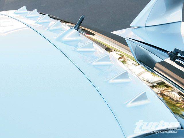

On a side note, I've seen at least one production car with vortex generators very similar to ones used on airplanes; the Mitsubishi Lancer Evolution VIII. Whether they're helpful in terms of mileage, no idea.
turp_0901_09_z+project_mitsubishi_lancer_evolution_ix_interior_exterior+vortex_generators.jpg

Vortex generators on cars? :) Cool idea as an aero enthusiast. As to it's usefulness in reducing drag to improve top speed performance and gas mileage? Hmmmm :).
Here's a scholarly report from Mitsubishi on the topic:
http://www.mitsubishi-motors.com/corporate/about_us/technology/review/e/pdf/2004/16E_03.pdf
They estimated for the Lancer that it reduced CD by .006. Given that car CD that I've seen listed between .30 to .25 a .006 improvement is roughly a 2% improvement. Given the velocities we drive our cars at I doubt that it could amount to much!
