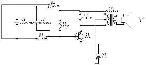

How does the transistor work in this circuit
The discussion focuses on the operation of a transistor configured as a Hartley Oscillator within a specific circuit. When switch S1 is down, a sound is emitted, and the pitch varies based on the position of switch S3, which alters the tuning capacitor values and consequently the frequency of the sound. The participants conclude that an NPN transistor is more suitable than a PNP transistor for this configuration, emphasizing the importance of bias voltages in the circuit.

In the circuit attached, when S1 is down, a sound is emitted from the speaker. When S3 is down(connected) a lower pitched sound is heard. When S3 is up and S1 is up, a high pitched sound is heard. I don't understand why the pitch changes in those settings, and I also don't understand the purpose of the transistor in the circuit. Why does it need to be there?EDIT: To view the image you have to click on the thumbnail and then click on the image that comes up, which looks black, and then you'll see it. IDK why that's happening..

Also, I think the transistor should be NPN instead of PNP with the bias voltages in the given circuit.
