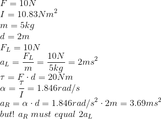

in this diagram i made:
[PLAIN]http://img201.imageshack.us/img201/1856/physicsqa.png
left: simple application of linear force at center of mass
middle: application of linear force offset from center of mass gives rise to torque around center of mass
right: how to explain the forces and torques here?
most books just say that the contact point with the fixed object becomes the fulcrum
but i want to understand how that happens
i have drawn about 20 diagrams - and none of them make sense
the closest to an explanation i have got:
as the torque is a force applied to all points in the mass
the contact force is 1/2 the torque
an equal and opposite torque reaction somehow adds this 1/2 to the original ...

I am trying to understand the hidden force diagram "behind" the typical force diagram in books
with a force of 10N and a distance from CoM of 2m the torque would be 20Nm
but with a pivot 2m from the center of mass (4m from the force) the torque is 14Nm
that is what I don't understand

You need to understand that, because torques generally depend on the point about which you calculate them. A notable exception is a "couple", i.e. equal and opposite forces, in that the torque they generate is independent of the reference point. Here you have a single force so it matters about what point you calculate the torque. It is best to calculate the torque about the fixed point, then it would be 40 Nm (not 14 Nm). Why is is the best point? Because then you will be able to calculate the angular acceleration of the object using Newton's 2nd Law for rotations and from this the linear acceleration of the CM.

So you need to replace the pivot with a pair of forces that will do the same job as adding a pivot in the simulation. Is that it? Can you post exactly what is given in this problem, i.e. dimensions of object, forces applied etc. I can only guess what these are.

I = 10.8333 (at center of mass)
mass = 5 kg
force applied 2 m away from CoM
pivot 2 m away from CoM
force, CoM and pivot are colinear
force applied is 10 N (perpendicular to force-CoM)
I am planning how to build a physics simulator
but there is no concept of a pivot - only rigid bodies (pos, vel, mass, moi, friction)
so a pivot could be modeled as (vel = 0, mass = moi = 9e99)
You mean "about" the center of mass. I assume the length of the rectangle is 4.0 m, correct? If the rectangle represents a uniform rod, then its moment of inertia about the CM should be
I = ML2/12 = 5*42/12 = 6.67 kg m2, not 10.833. So what is this I = 10.833?
Also, as the rectangle rotates, does the force stay perpendicular to the rectangle (i.e. rotates with it) or is its direction fixed?

the rectangle is 5x1
the force and pivot are inset 0.5
10.833 is the default Icm calculated by my (2D) simulator
maybe the simulator treats it as 5x1x1 I am not sure
[PLAIN]http://img826.imageshack.us/img826/2307/physicsqd.png
OK, so the length of the rectangle is 5.0 m not 4.0 m as I originally thought. Now I agree with the moment of inertia given by the simulation. What about the force? What is its direction as the object rotates? Also, is gravity in the picture or does this happen on a horizontal table? Finally, if I were you, I would turn friction off, understand the simpler problem, then turn friction back on.

Good. This is what you do.
1. Use the parallel axis theorem to find the moment of inertia about the pivot.
2. Use Newton's Second Law for rotations to find the angular acceleration α.
3. Use α to find the linear acceleration of the center of mass, aCM.
4. Use aCM in Newton's Second Law for linear motion to find the horizontal force at the pivot. Note that the pivot exerts no vertical force because all the forces are horizontal.

My suggestion is to replace the pivot with its effect on the rectangle, namely an additional force. You can find what it is by the method I described to you. So don't use a pivot to find that force, use the idea of "how much force must be exerted at point P located 0.5 m in from the end opposite to the one where F is applied such that point P is at rest while the rest of the rectangle rotates about it." Don't call it a pivot if you don't want to, but whatever it is, it must simulate the motion of the rectangle which requires that point P behave like a pivot, i.e. it is at rest while the rest of the body rotates about it. To do that, a force must be applied at P that you can find as I indicated to you.

and this is where the problem lays
I have spent days working out solutions to this and got nowhere
it seems to come down to that weirdness whereby:
force X applied at CoM - result = linear force N
force X applied away from CoM - result = linear force N + rotational force N (huh?)
i can't even decide what the force against the pivot is because:
the linear force is directed to the right
the rotational force is directed to the left
what is an "equal and opposite torque" ?
and how to relate these when they are no longer equal?
F = linear force + torque / d
F = a / (a+b) N + b / (a+b) N / d
there are some alternative approaches along the lines of:
Ax = Ay * |x-p| / |c-p|
alpha = Ax - Ay / |x-c|
etc. which might lead to a solution
but I cannot determine a force diagram that explains how a pivot works!
and that is the "hole" in the physics books I have
There is no force applied at the center of mass. The only force is F and that is applied at 0.5 from the top end of the rectangle. That's what your drawing shows, unless we are talking about a different problem.
Huh? is right. The above does not make sense.
That is correct.
What is this rotational force? What piece of the Universe exerts it on the rectangle?
Why do you ask? There is only one torque about the pivot and that is exerted by force F.
I gave you a detailed plan on how to do this. You say you did it already, then you should know what is going on here.
The above makes no sense.
A pivot works by exerting contact forces, i.e. it exerts whatever forces are necessary to provide the observed acceleration. So first you answer the question "what is the observed acceleration?", then work from there to find what forces are needed to be exerted by the pivot so you can get that acceleration. That's what I said you should do, you said you did it, so what's the problem?
"Rotational force" is another way of saying "torque," so you don't have a linear force N and a rotational force N. You have a linear force N and a rotational force rN, where r is the length of the lever arm.

Here is an idea that might lead somewhere:
s^{2}%20\cdot%202%20m%20=%203.69%20ms^{2}\\%20but!\%20a_{R}%20\%20must\%20equal\%202%20a_{L}.png
Thanks for your efforts - I am off to bed
WildEnergy said:
I am saying that I am not trying to solve a single physics puzzle ... but work out an approach to writing a physics simulator - this means I am looking for a generic approach, not one that requires a human brain to recognize pivots - but an approach that takes a set of rigid bodies and forces and calculates resulting accelerations
I guess what I'm asking is what you mean by "recognize pivots." We're just saying you replace it with the force it exerts on the body. As far as the equations go, you wouldn't be able to tell that the force is from a pivot or caused by some other agent.
If you're saying you want to solve the problem without having some sort of constraint that says the body pivots about a point, you can't do it because it's a different problem. Somehow the information that one point on the body doesn't move has to enter the problem somehow, whether it's in your assumption about the accelerations or about the force exerted at the point the pivot acts.
