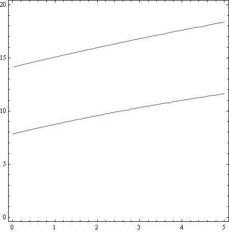

Hi
In the article: "Beam to String Transition of Vibrating Carbon Nanotubes Under Axial Tension" I have found an equation that describes the resonance frequency of a beam under axial tension.
However, I have some problem solving it.
The equation looks like this:
x + y*Sinh[y + Sqrt[y^2 + x^2]]^0.5*Sin[-y + Sqrt[y^2 + x^2]]^0.5 -
x*Cosh[y + Sqrt[y^2 + x^2]]^0.5*Cos[-y + Sqrt[y^2 + x^2]]^0.5 = 0
x is the dimensionless natural frequency and y is the dimensionless natural frequency parameter.
I want to find the x for different y.
I have tried to solve this equation i Mathematica but without much success.
Can anyone help me?
Since you have x both "inside" and "outside" a transcendental function, I doubt the equation can be solved in terms of elementary functions. You might be able to write the hyperbolic functions in terms of exponentials and use Lamberts W function (defined as the inverse function to [itex]f(x)= xe^x[/itex]) but I wouldn't like to try!
Oh, come on guys. Let's try. I mean, he said nothing about getting it exactly right. So first just make a contour plot of it in some desired range, say y in 0 to 5:
Code:
cp1 = ContourPlot[
    x*Cosh[y + Sqrt[y^2 + x^2]]^0.5*Cos[-y + Sqrt[y^2 + x^2]]^0.5 ==
   0, {y, 0, 5}, {x, 0, 20}]
That's below, and suppose I want the value of x when y is one. Well, from the plot, it looks about 8 and 15 right? So let's use Find root to get it closer:
Code:
In[97]:=
f[x_, y_] :=
myx = Re[x /. FindRoot[f[x, 1] == 0,
     {x, 9}]]
N[f[myx, 1]]
     {x, 15}]]
N[f[myx, 1]]
Out[98]=
8.781804090459223
Out[99]=
1.8616219676914625*^-12
Out[100]=
15.099644858445615
Out[101]=
6.752998160663992*^-10
Now I think I could pull at least a B for that effort. :)
