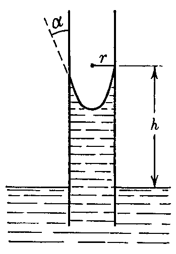

Are you talking about this?
See attached pic.
