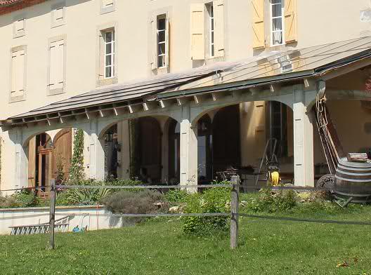

My brother in law had this installed while I was there this month:
To the right are solar heat exchangers to heat water boilers, to the left are 16 solar electric panels. The lattitude of the building is about http://www.panoramio.com/photo/28211862, so you can do your calculations and he was told that the installation would be good for an average of 3000 watt, the legal maximum for private grants in France.
As soon as the installation was operational, a week or so ago, we observed the indicator giving a maximum momentarily yield of 1950W indicated on a bright day at noon, and about 400W maximum on a very dim rainy day. He was not very satisfied with that.
The heat exchangers meanwhile heated the warm water reservoirs to around 70C.

Andre said:
The http://library.thinkquest.org/20331/types/solar/problems.html.
To the right are solar heat exchangers to heat water boilers, to the left are 16 solar electric panels. The lattitude of the building is about 43 degrees north, so you can do your calculations and he was told that the installation would be good for an average of 3000 watt, the legal maximum for private grants in France.
If there is a single bad/sub-par panel in the works, or if there is any shadow at all on ay of the panels, PV yield will drop. This is my guess for the poor performance. I personally am still waiting for the right moment before I install PV on my perfectly-situated, south-facing garage roof.
No shadow there, but we have no insight in the proper condition and installment of course. I'll check on that.
