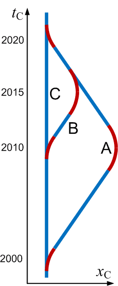

It is clear from the diagram that both twins experience equal proper acceleration in the depicted scenario. The differential ageing comes about because they accelerated at different times and places. I.e. it is better to say that the differential ageing is due to different paths through spacetime.

In another thread, I have analysed the exact differential ageing of the twins experiment including the time dilation that happens during the acceleration in a non-zero time interval to within a second in an experiment lasting years. I have not ignored the acceleration and calculated the contribution exactly, and it can be shown that that if the acceleration phase is limited to seconds in an experiment lasting years, the maximum error that can be introduced by ignoring the acceleration is of the order of seconds, while the differential ageing due to different spacetime paths is of the order of years. See #24 of this thread: https://www.physicsforums.com/showthread.php?t=422350&page=2
While you might understand the limitations of saying the twins paradox is explained by acceleration, it is confusing to beginners, because as it says in the PF FAQ, the clock hypothesis states that "the tick rate of a clock when measured in an inertial frame... is independent of its acceleration"
This is funny. I was just about to post the reply you can see below when I saw kev's post. I even thought I had discovered a new trick by img-tagging a previously uploaded image, but apparently kev already knew that trick. :smile: I was somewhat confused when I previewed and saw the image twice.
__________________
I agree with kev about the specific statement "acceleration is not the physical cause of differential ageing of the twins". It would be silly to say that it is the cause, since they can accelerate the same and have different ages at the end:
<the exact same image that kev just linked to>
This scenario was described by Kev in a post he made in 2008, which inspired DrGreg to draw this diagram.

I agree that it is an issue of semantics, but note that the red parts of the left curve are identical to the red parts of the right curve. The only difference between the two curves is the times at which they initiate their scheduled velocity changes. (It's "the only difference" in the sense that if those times had been the same, the curves would have been identical). This causes them to spend different amounts of time at the two different constant speeds, and this alone accounts for the age difference.

I agree that it is an issue of semantics, but note that the red parts of the left curve are identical to the red parts of the right curve. The only difference between the two curves is the times at which they initiate their scheduled velocity changes. (This causes them to spend different amounts of time at the two different constant speeds, and this alone accounts for the age difference).
Yep, but I would still say they don't have the same pattern of acceleration as the amount of proper time they spend at zero acceleration for each period of zero acceleration is not the same. But as we both agree it's semantics, entirely dependent on the way I've choosen to define the concept of 'pattern of acceleration'.
