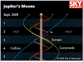

One of the first things I did with my scope was plot the positions of the Galilean moons over the course of a couple of weeks. Very cool.
Looks like a quadruple helix curling around a cylindrical Jupiter. Each helix has...
Oh wait. A picture is worth a thousand words.
