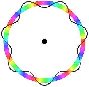

If you look at the picture below, it’s pretty obvious what de Broglie talks about:
This example of the hydrogen atom, shows de Broglie wavelength of one electron, with 7 phases.
As you can see we can only have fully completed phases = integers. It would be impossible for an electron to have 6.5 phases – since it would NOT make a complete "circle"!
Hope this helps. :wink:
(Here’s more info on the http://en.wikipedia.org/wiki/Matter_wave" .)

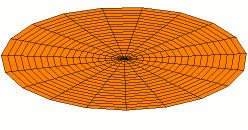

Yes, good info granpa. This also leads to maybe the "fundament" of it all... http://en.wikipedia.org/wiki/Standing_waves" .
This shows that my first picture is naive; the real world is (probably) "more dimensional"...
A higher harmonic standing wave on a disk with two nodal lines crossing at the center

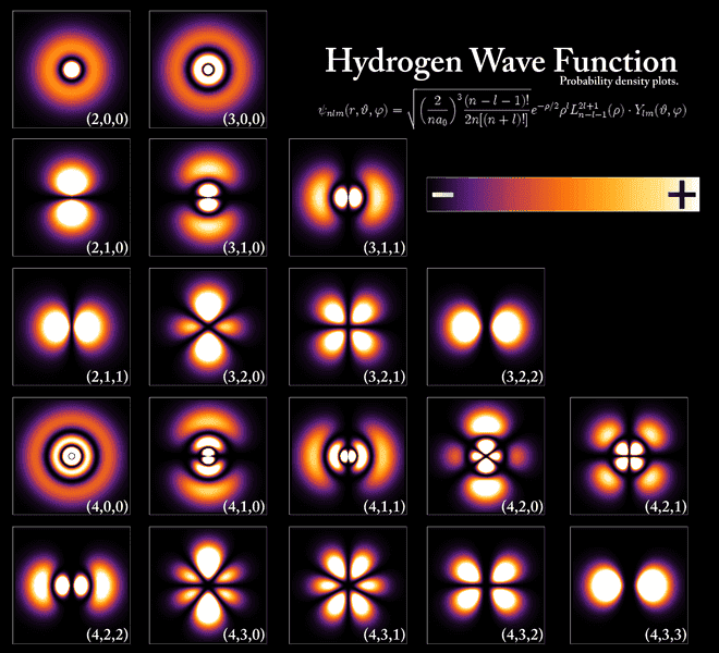

This one is interesting:
The electron probability density for the first few hydrogen atom electron orbitals shown as cross-sections. These orbitals form an orthonormal basis for the wave function of the electron. Different orbitals are depicted with different scale.
