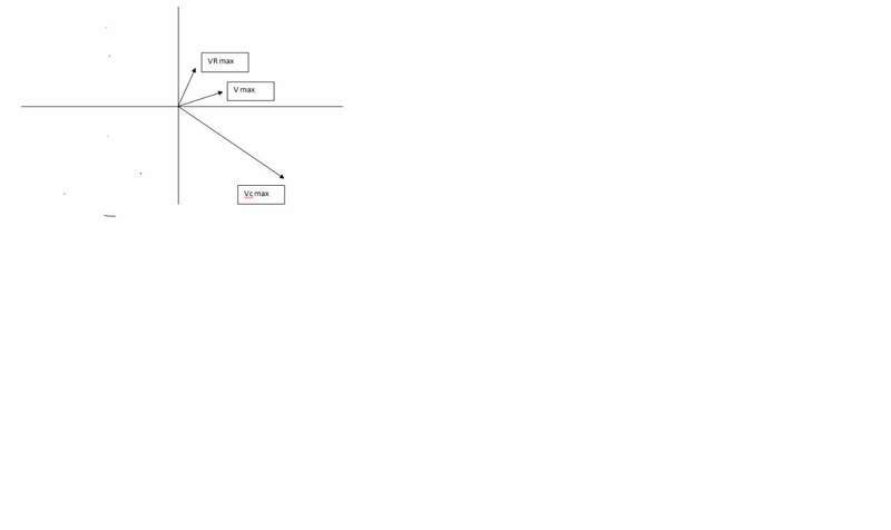

e) Draw the phasor diagram of voltages and current for the circuit.
This one I'm not sure about, Its pretty much exactly the same as the one in my text but vc max should be the vector sum of v rmax and vmax but it is always shorter than those two in the text ands its longer for me? btw its the attached pic
Current I is along the x-axis.
V_R is along + x-axis
V_L is along +y-axis
VC is along - y-axis.
Thanks,
Is that how phasor diagrams always go, won't they always be the same regardless of the circuit??
anything else that you notice that could be wrong with my answers??
Yes. The phasor diagrams are always drawn in that way.
Other things appear to be quit OK.
ok Thanks I will make that change
