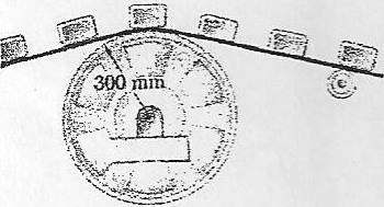

A series of small packages is moved by a conveyor belt that passes
over a 300mm radius pulley. The belt starts from rest at t=0 and its
speed increases at a constant rate of 150 mm/s2. The
coefficient of friction is μ=0.75. Determine the time the first
package slips.
Answer: ts=11.32s

These are equations for polar coordinates, which I'm thinking I may need to use to solve the problem.
[tex]F_{r}=ma_{r}[/tex]
[tex]F_{\theta}=ma_{\theta}[/tex]
[tex]F_{net}=F_{r}{\bf e}_{r}+F_{\theta}{\bf e}_{\theta}[/tex]
[tex]m(\ddot{r}-r\dot{\theta}^{2})=F_{r}[/tex]
[tex]m(r\ddot{\theta}+2\dot{r}\dot{\theta})=F_{\theta}[/tex]
First of all, I'm trying to decide if I should use cartesian, polar, or path coordinates for this problem.
If cartesian coordinates work, then I would set the problem up as below. Also, I don't think the radius of the pulley would matter...?
Sum of forces x-dir = -Fs+Fpulley=ma
Sum of forces y-dir = N-mg=0 -----> N=mg
The maximum static friction would be Fssmg.
For polar or path coordinates, I wouldn't know where to start.
I'm getting closer... I think.
I actually think I can solve this without using polar or path coordinates.
So, for constant linear acceleration, we have:
vf2=vi2+2a(x2-x1)
Because x2-x1 is really 2πr (arc length), we have:
vf2=vi2+2a(2πr)
I can solve this for vf and then plug that into vf=vi+at to get time... But I'm missing something with the whole Fssmg=ma... Like it should factor into the acceleration value for the two formulas above. Any help?
