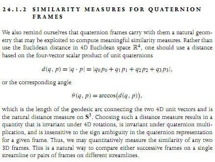

From my calculations the geodesic distance between two unit quaternions q,q' is given by:
[tex]D(q,q')=\arccos (|1-\frac12||q-q'||^2|)[/tex]
See the attached extract from Hanson, "Visualizing quaternions".

Uhm...
I am bit confused now.
The formula that is shown on the scanned page is different than yours: Hanson basically computes the scalar product between two (unit?) quaternions and says that it is the cosine of the angle between them. He uses the ordinary "euclidean inner product".
You instead seem to use the inner-product commonly associated with the conformal model of geometric algebra [itex]\mathcal{C}\ell_{4,1}[/itex], which is: [tex]-\frac12(q-p)^2[/tex]. Then you say that the cosine of the angle is "1 minus the inner product".
What is the difference/advantages/disadvantages between the two?
Personally, I was even thinking of using the bare Euclidean distance between points on the 3-sphere. it works for both the unit circle in 2D and the unit sphere in the 3D.
Simple calculation in the 4d Euclidean space :
[tex]||q-p||^2=(q-p,q-p)=||q||^2+||p||^2-2(p,q)=2(1-(p,q))[/tex]
You can calculate |(p,q)| from this.

You compute the d(q,q') which is a chord-length and then simply retrieve the arc-length.
Now everything is clear.
