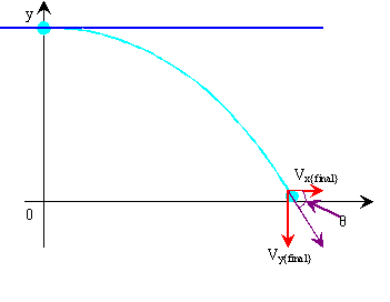

Problem: A stone is tossed horizontally off a 50.0 m cliff at a velocity of 18.0 m/s. a) How long does it take for the stone to strike the ground? b) With what speed and angle of impact does it land?
I have drawn 2 diagrams, one depicting the height of the cliff and the trajectory of the stone and the other a right angle triangle to determine the unknown angle and the unknown distance (x). I have chosen the coordinate system where x represents the ground and is positive and horizontal and y is positive up from the ground. We are not to consider any resistance upon the stone and we are considering the projectile motion from the time of release until just before it strikes the ground.

I am attempting to solve for theta first and thus am using my second illustration. I know my vertical component y = 50.0 m and that is my Vnaught(y) and I know my hypotenuse Vnaught is 18.0 m/s. When trying to solve for Vnaught(x) using the pythagrean therom I am coming up with an entirely different answer than that given me in the book.
My approach: b^2 = c^2 - a^2
sqr b^2 = (sqr 18.0^2 - sqr 50.0^2)
sqr b^2 = (sqr 324 - sqr 2500)
sqr b^2 = (sqr -2176)
b = 46.6 m Vnaught(x) then = 46.6 m
Solving for theta: theta = tan(-1)(-46.6/50.0) = -42.98 deg.
The book's answer is -60.1 deg.
What am I missing?
What is Vx(final) and Vy(final) ?
Only when you find these 2, you can apply the trigonometry formula.
What is the magnitude of V, the thing we call speed, after you have found the above.
so at the top [tex]V_{y} = 0[/tex] so [tex]V_{x} = 18m/s[/tex]
info
[tex]Y_{o} = 50 m[/tex]
[tex]V_{xo} = 18 m/s[/tex]
[tex]V_{yo} = 0 m/s[/tex]
[tex]X_{o} = 0[/tex]
[tex]\theta_{o} = 0^o[/tex]
Using this kinematics equation
[tex]V = V_{o} + at[/tex]
so
[tex]V_{y} = -gt[/tex]
[tex]-\frac{V_{y}}{g} = t[/tex]
and using this equation
[tex]Y - Y_{o} = V_{o}t + \frac{1}{2}at^2[/tex]
when it hits the ground y=0 so
[tex]-Y_{o} = -\frac{1}{2}g(-\frac{V_{y}}{g})^2[/tex]
[tex]-Y_{o} = -\frac{V_{y}^2}{2g}[/tex]
[tex]2gY_{o} = V_{y}^2[/tex]
